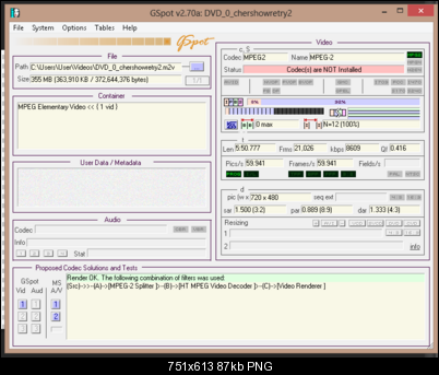

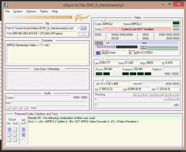

    Here is gspot
  2. I don't need gspot, the mediainfo was actually enough to say what was wrong
    Or you can use hcenc separately. The script should be fine as is (If you use AssumeFPS), something else is causing avs2dvd to encode progressive 59.94, instead of interlaced 29.97
    If you want to figure out what's going on, post the log file
  3. I did post the log file in the post right before the gspot one

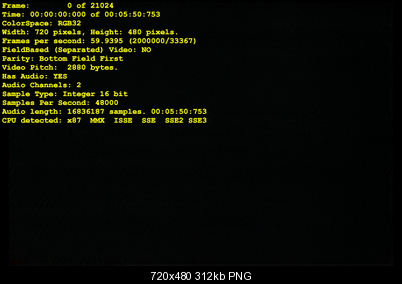

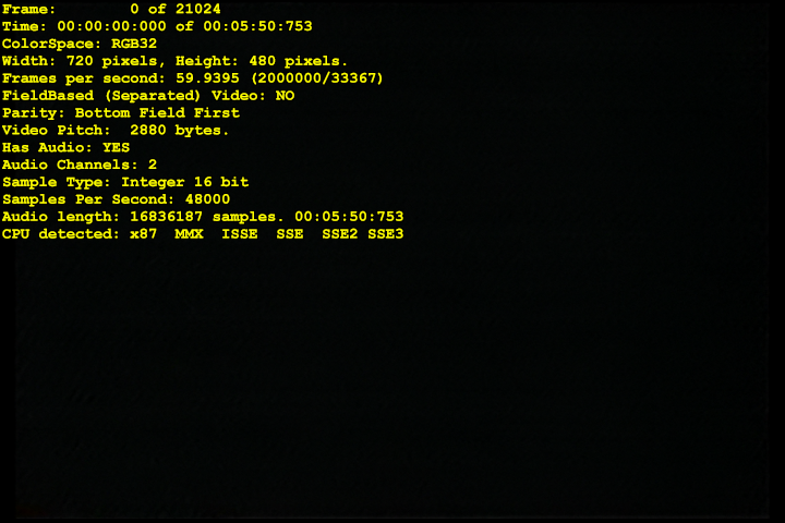

    frame rate

  27. Originally Posted by Cherbette View Post
    What's a good anti-aliasing filter I could use instead that wouldn't cause such issues
    You already avoided that problem by running Santiag() and FineSharp() before interlacing. I'd go ahead and move AddGrainC() before it too.
    That problem has nothing to do with your issue of 60p output from the MPEG 2 encoder.
