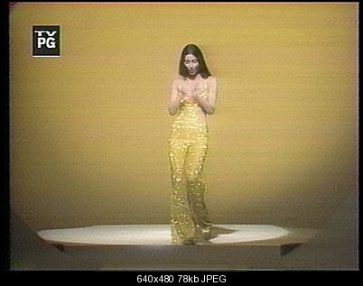

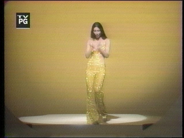

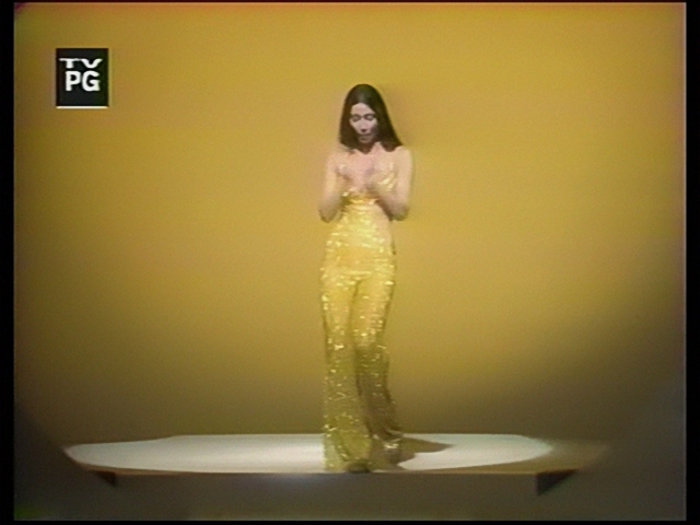

    Frame 225 before and after. It's a toughie. Looks soft to begin with, probably on purpose. A soft image under an ocean of hard noise. The original already shows signs of blocky noise and banding that you'd get after encoding, so I used lots of dithering. There's still some rainbow leftovers, and top and right border stains. You can throw more plugins at it, but Cher would disappear. I noticed that some of those shiny specs were removed by the fsn filter.

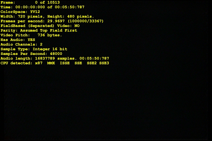

    Is the video 30000/1001 frame rate ? In your script, add info() at the end and preview in vdub, what does it say about the framerate?
    What are you using to encode ?
  15. Click image for larger version
    I'm using avstodvd

    TITLE 1 SOURCE FILES
    Video: C:\Users\User\Documents\chershowretry2.avs
    Info: AviSynth - 0 kbps - 720x480 - DAR 1.5 - 29.97 fps (CFR) - 5:50 minutes - 10513 frames
    Audio 1: C:\Users\User\Documents\chershowretry2.avs
    Info: AviSynth - 0 kbps - CBR - 2 ch - 48000 Hz - 2 bit - 5:50 minutes (0 ms delay)
    [AVSMeter.exe]
    <8/11/2014 3:10:38 PM>
    AVISYNTH SCRIPT
    Video = Import("C:\Users\User\Documents\chershowretry2.avs ")
    Audio = Import("C:\Users\User\Documents\chershowretry2.avs ")
    Video = Video.ConvertToYV12()
    Video = Video.AddBorders(0,30,0,30)
    Video = Video.Spline16Resize(720,480)
    AudioDub(Video, Audio)
