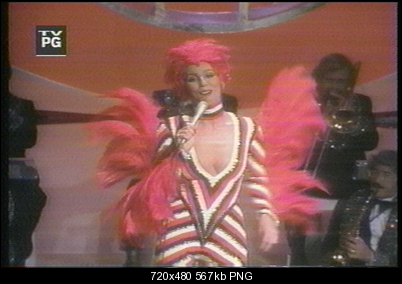

  1. Recently I acquired some 1st generation VHS that belonged to a friend mine who has passed. These are episodes of the Cher Show (solo) that re-aired on VH1 in 1998/1999. This series has never been on DVD and any advice on cleaning it up would surely be appreciated. I'm fairly familiar with VirtualDub and I'm becoming more familiar with avisynth using avspmod. Thanks
    https://www.mediafire.com/?vcg8v6llu3oufra
    15 second sample utvideo codec

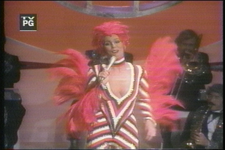

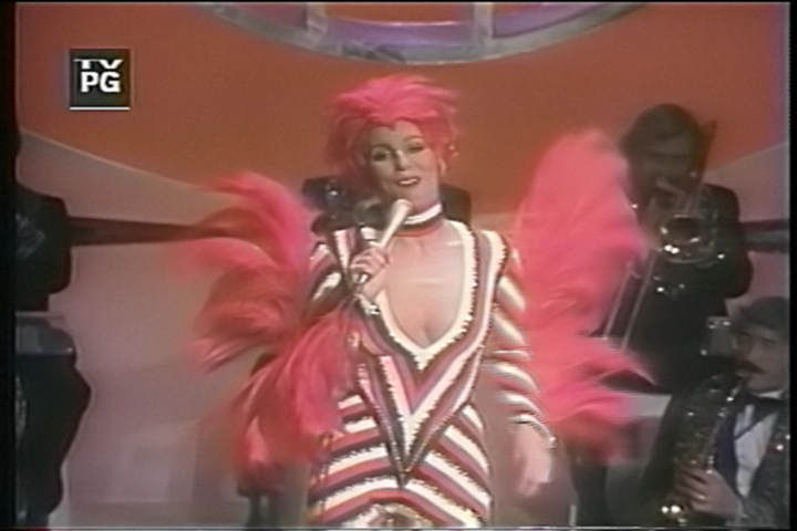

    Herringbone pattern is apparent - flaws inherent from VHS source and capture, or maybe analog cable (as mentioned) and some crosstalk on those reds and pinks (also as mentioned).
    Looks like a job for a couple of resizes (down to 360x480 with precise bilinear then back up to 720x480 with lanczos to eliminate the crosstalk) and a strong dose of Neat Video with the temporal filter for that wavy noise.
    Not perfect but, for it being the middle of the night here, it will do.
    Source:
    Processed:
