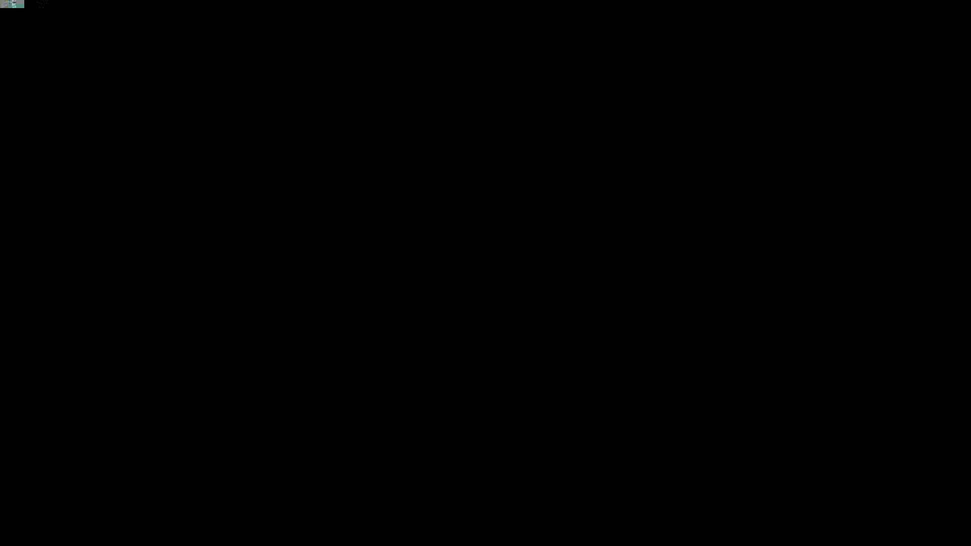

  1. I converted the trimmed sample video to mp4 using MkvtoMp4. Now instead of lagging at the beginning, it shows me what can be seen in the first attachment (very small picture in the upper left corner) and then after a second or so, it shows me what you see in the second attachment - but at this point taking a snapshot produces a full-size non-glitched frame screenshot.
    I'll try re-encoding and see if it helps.

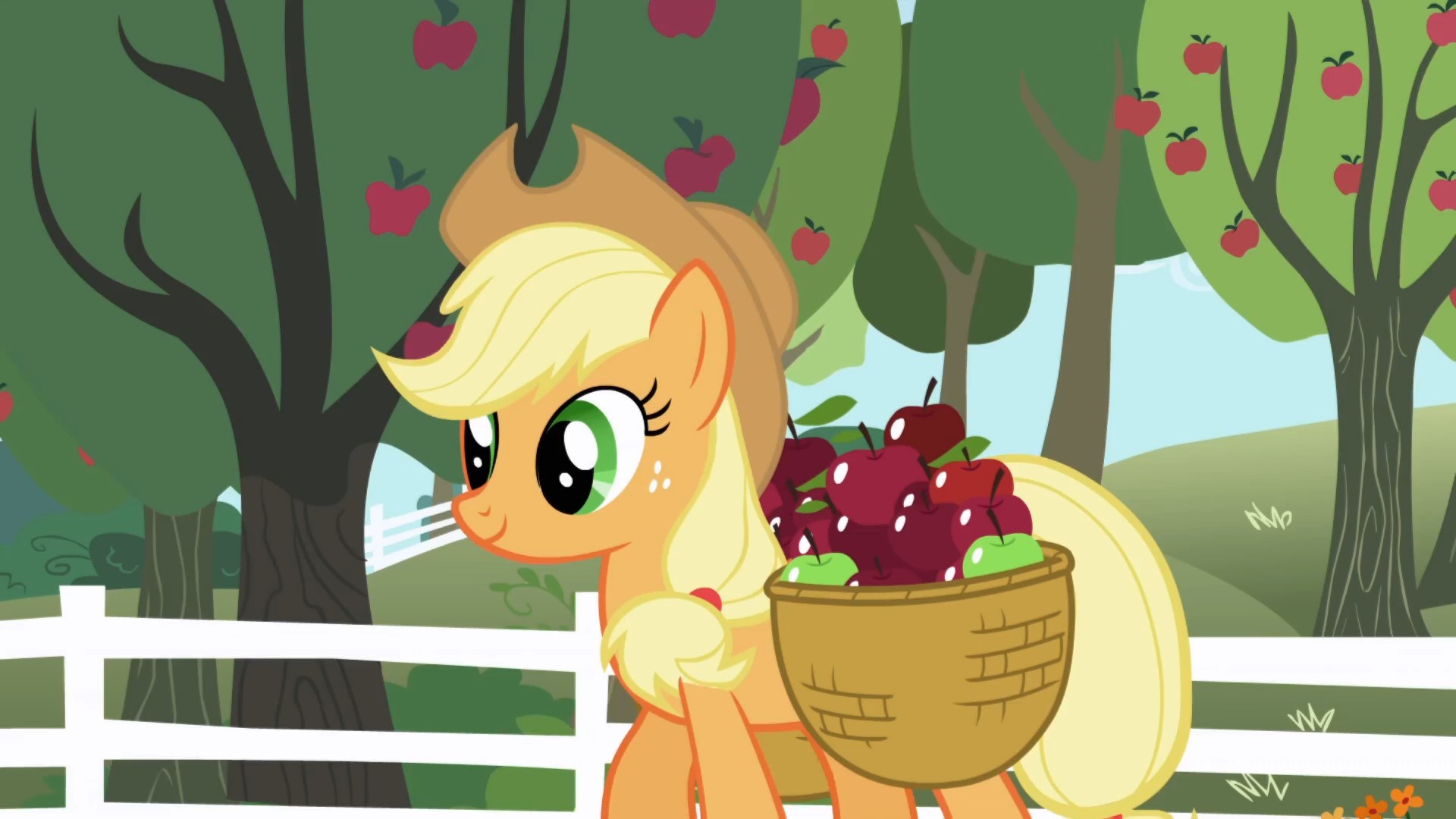

  8. I re-encoded using Handbrake. Output file's size was considerably lower than the original, but the difference in quality is extremely negligible (see attachments - first pic is old, second is new). After that, I trimmed it with MkvCutter and finally - there are no problems with the playback. Thanks for the help!

    Sep 2012
    Australia
    Animation tend to compress well. I THINK I can see a difference in that little bit of green poking up over the fence under the ponies chin, but since JPG uses compression too it may have exaggerated the problem. I can definitely see a difference in the file size though, it looks as though the new version is easier to compress. You can generally do a hell of a lot of damage to cell animation without it being noticeable during playback, most of the time it just looks like an alternate form of artistic style.
  10. Weird. On non-enlarged picture that green thing difference is visible, but not on the actual size image.

    Huh? Where's the actual size one if not there? If I expand those pictures by clicking on one, start up the windows magnifier and switch between the two the difference is even more profound.

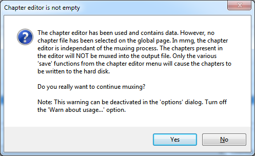

  27. It shows me this error when I try to add chapters.
    Am I supposed to write a text file containing chapter data and add it to the container? If so, why does the chapter editor allow making new chapters in a file with no chapters?

  28. Member
    Sep 2012
    Australia
    [Chapter Editor | Save] OR [Chapter Editor | Save to Matroska File]
    NOT [START MUXING]!!!
