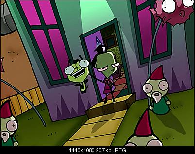

  2. They probably use AviSynth and filters like nnedi3_rpow2(), Toon(), aWarpSharp2() etc. Similar 480p to 1080p upscale of animated material:
