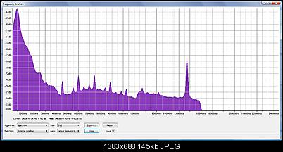

  1. I have audio ripped from a DVD that was a conversion from a VHS home video. The spectrum of the audio + the noise is as follows:
Name:	audio spectrum.jpg

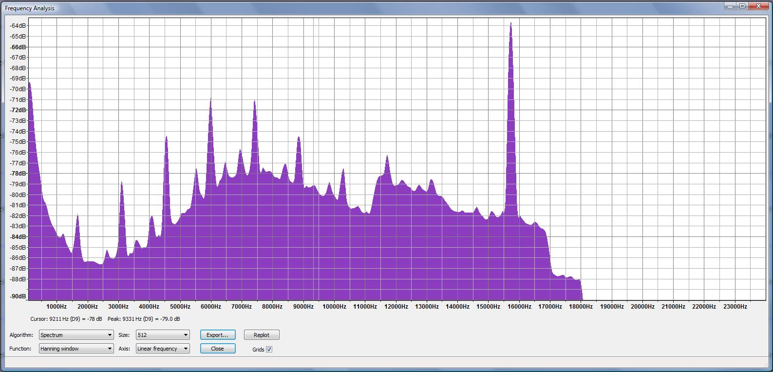

    The spectrum of the noise/tape hiss by itself is as follows:
    Is there any way to filter that tape hiss noise out of the audio? It looks like the noise spectrum cuts right through the spectrum of the audio I want to keep. I tried using notch filters in Audacity to notch out all of the higher frequency peaks of the noise, but it didn't make much of a difference in the overall noise level and was starting to affect the quality of the audio I wanted to keep.
    I also tried Audacity's noise filter where you give it a sample recording of the noise. It did filter a lot of the noise out, but had too big of an impact on the rest of the audio.
    I'm guessing I would have to completely wipe out all the frequencies in the noise spectrum above, which would severely affect the sound I want to keep.
    Is there anything else I can try? Am I missing something here? Would a paid software program do a better job?
