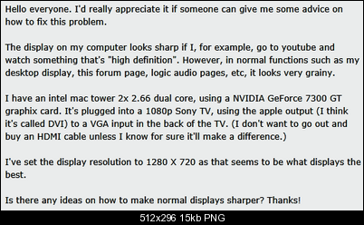

  1. Hello everyone. I'd really appreciate it if someone can give me some advice on how to fix this problem.
    The display on my computer looks sharp if I, for example, go to youtube and watch something that's "high definition". However, in normal functions such as my desktop display, this forum page, logic audio pages, etc, it looks very grainy.
    I have an intel mac tower 2x 2.66 dual core, using a NVIDIA GeForce 7300 GT graphix card. It's plugged into a 1080p Sony TV, using the apple output (I think it's called DVI) to a VGA input in the back of the TV. (I don't want to go out and buy an HDMI cable unless I know for sure it'll make a difference.)
    I've set the display resolution to 1280 X 720 as that seems to be what displays the best.
    Is there any ideas on how to make normal displays sharper? Thanks!

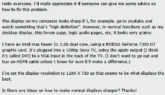

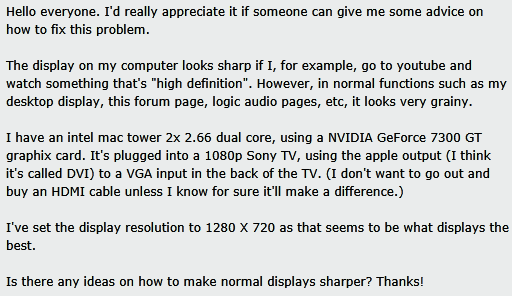

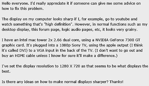

  6. Since nobody knows exactly what you're seeing on the TV here are some examples:
    Normal:
    Poorly scaled (computer output doesn't match TV's native resolution, overscan simulation):
    Over sharpened:
