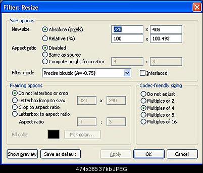

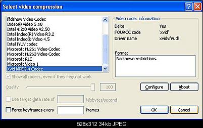

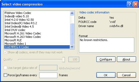

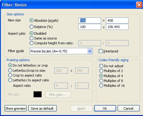

    I am using Xvid codecs. After i applied mod 4 frame size new error occurs: Unable to intialize video compression. Check that the Video codec is compatible with the output video frame size and the setting are correct or try a different one. "
    I am using Xvid MPEG 4 codec for compression. All settings are used as defaults.
    I am using resize filter where i changed values after ur help according to mod 4. Current setting is 720 * 408.

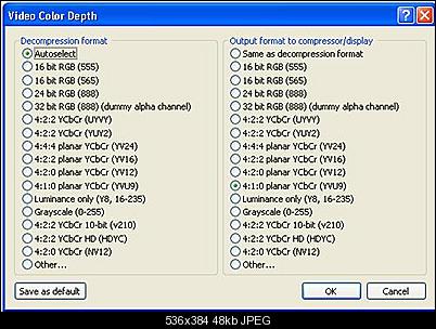

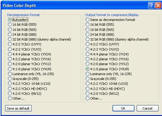

    Collor Depth is:

  10. As was pointed out by Selur, Xvid doesn't support YVU9 as input. Change to YV12.
    Mar 2014
    Pakistan
    Thanks alot for your support. My problem is solved. I changed to YV12. Thanks again.
