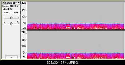

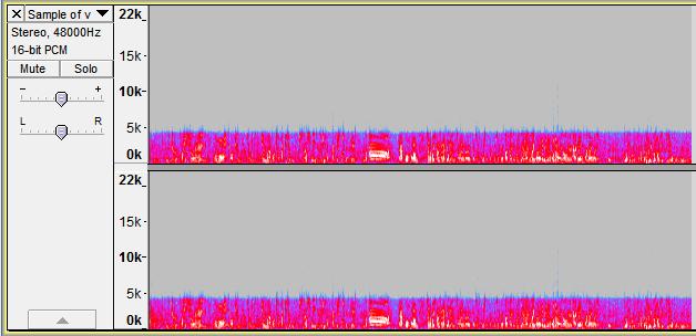

  28. If you look a the spectrum of the database audio it has almost nothing over 4 KHz:
    Here's my guess: they run a steep 4 KHz low pass filter on some original audio (probably Cinavia-free audio from a DVD) then encode that with something like AAC. That gives very dull sounding audio but it can be compressed a lot with fairly few artifacts. That's the content of the "database" (presumably they do it this way because their software is very slow). Then when you run their software on your computer they take your audio and run it through a steep 4KHz high-pass filter to get all the high frequency content. Finally, they mix the two together to get a full spectrum track.

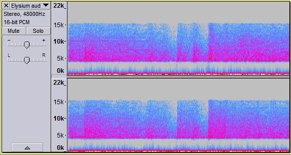

  30. Kerry56, thanks for that sample. It's pretty much as I suspected, they use the high frequencies from your audio and mix them with the low frequencies of the "database".
    It's slightly different in that they take both high and very low frequencies from your audio, and the middle range from the database.
    What remains to be seen is whether the database audio is from an unprotected source, or a Cinavia protected Blu-ray disc (mangled enough to "remove" Cinavia). I suspect the former. Otherwise they could do what they're doing all on your computer and there would be no need for the database.
