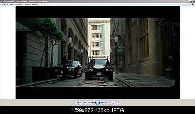

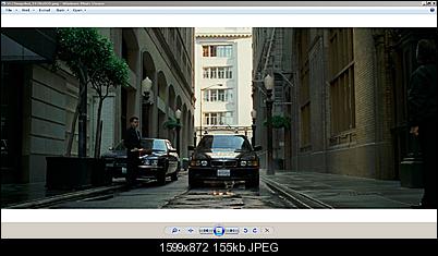

  1. Hello and thanks in advance for any help. And my apologies if I don't explain myself clearly enough for helpful understanding as I'm rather confused. I've 2 Blu-ray rips of the same movie, with the same video bit rates, and I'm trying to understand which video is technically of the higher quality and why. When I play the videos with VLC and KMPlayer they display the exact same aspect ratio, having the same size black bars top and bottom and showing the same visuals on the left and right sides of the screen; that is, neither video appears to be cropped, at least as I understand cropping, because neither seems to have any video information missing. However, MediaInfo for the two files is quite different, one being 1920*800 (2.40:1) and the other being 1920*1080 (16:9). Also, VLC snapshots of each have the same corresponding MediaInfo differences in width and height, however, when opened with Windows Photo Viewer the 1920*800 snapshot is fullscreen but the (bigger?) 1920*1080 snapshot appears as a smaller rectangle within the frame (see attachments). To (hopefully) simplify:
    1) How can two video files with radically different MediaInfos appear the same when played back?
    2) Which of these files, if either, is technically of higher quality and why?
    Thanks again for any help and sorry for my lack of technical knowledge in my explanation of the files .
ID:	23803 1920*800 VLC Snapshot
ID:	23804 1920*1080 VLC Snapshot

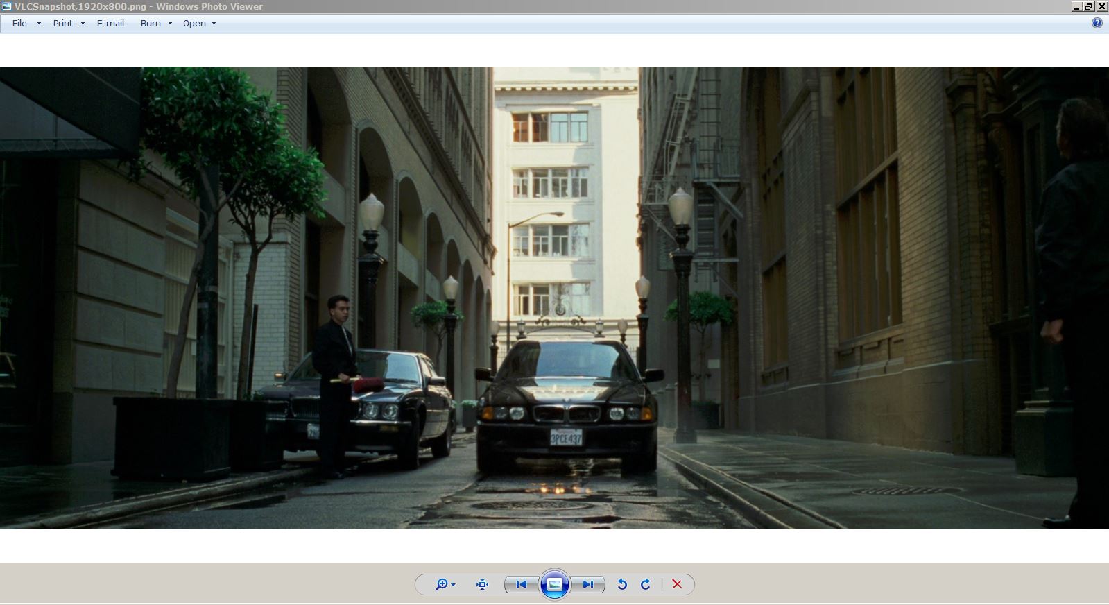

  2. This is a joke, right?
    The top one was reencoded with the black bars cropped away and the player adds them during playback. The bottom one was reencoded with the black bars intact.
    If, as you say, the bitrates are identical, then the quality of the two is virtually the same. Encoding black bars takes almost no bits. But there may be some other different encoding settings and there's no real way to tell, given the limited amount of information we've been supplied.
    That bottom picture isn't the same percentage size as the top one. I think if you pressed that magnifying glass thing with the +, you could make them the same width.

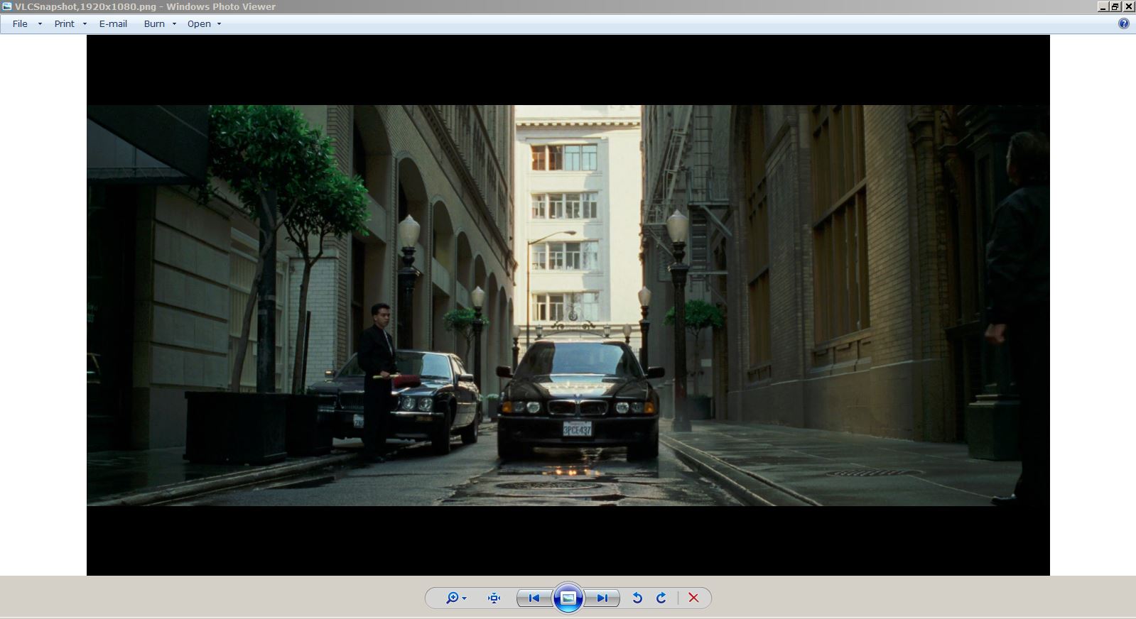

  3. Member Cornucopia's Avatar
    I'll try to give the answer to what I think is going here:
    May not be the actual original, but the 1920x1080 is likely more upstream than the 1920x800. Why?
    1. Blu-ray (and DVD) does NOT support a native DAR of 2.40:1. Neither supports anything but 16:9 (and 4:3 in the case of SD material).
    Therefore, a movie with a native DAR of 2.40 must be fit into a 16:9 box, and the standard way of doing that is via Letterboxing.
    The other clip (1920x800) was extracted from this and subsequently cropped (and then re-encoded).
    Note: both clips display the same desired payload AR (the part of the screen YOU are interested in), but the former has an actual CONTENT AR of 16:9 (which includes the hardcoded letterboxing in the storage and in the calculation of AR), while the latter has a content AR of 2.40:1 (which does NOT include the letterboxing).
    Since you didn't show the MediaInfo text, we couldn't verify this, but I'm confident it would concur with my guess.
    What a media player would do would be to attempt to play both in Full Screen (assuming a 16:9 screen output display). The former would already be formatted for 16:9, so it would be either a 1:1 pixel-match or would be a simple equally-constrained scale-up or down (depending on the rez of the display), while the latter would default to adding its own letterboxing upon playback (in realtime) to make the ARs fit. In some softwares, like VLC that can be adjusted to STRETCH, zoom, crop, or leave unscaled, just like the options usually available to consumer TVs. But not ALL software has that capability. Windows Photo Viewer is likely a good example of that: In this instance above, the windowed user display area is ~2:40:1, so it fits the 1920x800 out to fill it exactly, while the 16:9 letterboxed 1920x1080 version cannot be anamorphically stretched, nor can it be symmetrically zoomed & cropped, so it is filling the biggest 16:9 space within that user windowed area that it can.
    In answer to your 2nd question, while my intuition would lead me to think that the 1920x1080 is the higher quality (due to not being re-compressed?), there's no real way of us knowing since we haven't been given the generational provenance of the files.

  5. Originally Posted by LouieChuckyMerry View Post
    ... but why would someone actually take the time to crop the black bars before reencoding if the quality doesn't change...
    Of course the quality changes. They've both been reencoded from some retail Blu-Ray. Those might be 25-30GB. Are these that size? I crop black bars too. Maybe some people don't. This is downloaded stuff, right? When you encode your own stuff you can make them any way you like. If you want to turn around and make another Blu-Ray you need the black bars, and maybe that's the reason one encoder left them on - to make it easier to make a Blu-Ray, so you don't have to reencode yet again.
    And why doesn't the player honor the video's new (due to cropping of the black bars) aspect ratio?
    What new aspect ratio? The active video for both is the same. The aspect ratio is the same (square pixel, 1:1). One is 1.778:1 with black bars, the other 2.40:1 with the letterboxing cropped away. Why shouldn't they play exactly the same way?

    The black bars are included in the Bluray aspect ratio as though they were part of the picture, or as if they actually contained picture. In your example though, the picture itself is 2.40:1, but the black bars combined with the picture gives you 16:9. Once the black bars are removed, what's left is 2.40:1.
    If you don't crop the black bars when encoding, you're wasting bits encoding a picture area which is nothing but black, and the presence of black bars can have a small effect on how the picture itself is encoded. If they're removed, they can't.
    The player does add the black bars back on playback, but it'll only add them back in the same way if the screen being used is 16:9. If the screen has a different aspect ratio, then the player will display the video until the width (or height) fills the screen. It'll then add back whatever black bars are required to make up the difference between the picture aspect ratio and the screen aspect ratio (when the video is running in fullscreen mode).
    In the case of your screenshots that's effectively what's happening. Your monitor may be 16:9, but the player itself is occupying part of that with the menu and navigation bars so what's left for displaying the video isn't 16:9. When the black bars are included in the video (total 16:9 aspect ratio) the player resizes the video so the entire 16:9 picture (black bars included) fill what's left of the screen. The end result is it runs out of screen height before the width is wide enough to fill the display. Normally the player would then add black bars down each side too, but in your second screenshot they're white as Windows Photo Viewer wouldn't do that.
    Without the black bars, the picture (in this case) can be resized until the width fills the screen. The player would then add smaller black bars top and bottom to make up the difference, but once again in the screenshots using Windows Photo Viewer they're white.
    The upshot of it all is if you're viewing the video using a 16:9 screen, and the video is running fullscreen (the player window isn't using part of the screen area) the video containing black bars and the version without them should display in exactly the same way. With the black bars included the picture plus black bars =16:9 and fills the screen. Without black bars included the picture is 2.40:1 and the player adds the black bars to once again make up a total apsect ratio of 16:9 and fill the screen.
    Assuming both those videos were encoded using the same Bluray source (they're both only one generation away from the "original") and assuming the video bitrate is the same each time (and assuming the same encoder settings were used etc) then the quality of your two videos would be pretty much the same. The black bars do use a little bitrate if they're encoded, but it's pretty minimal, and they can effect the way the picture itself is encoded, but the effect is very, very small, so all else being equal the quality would be the same.
