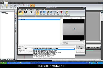

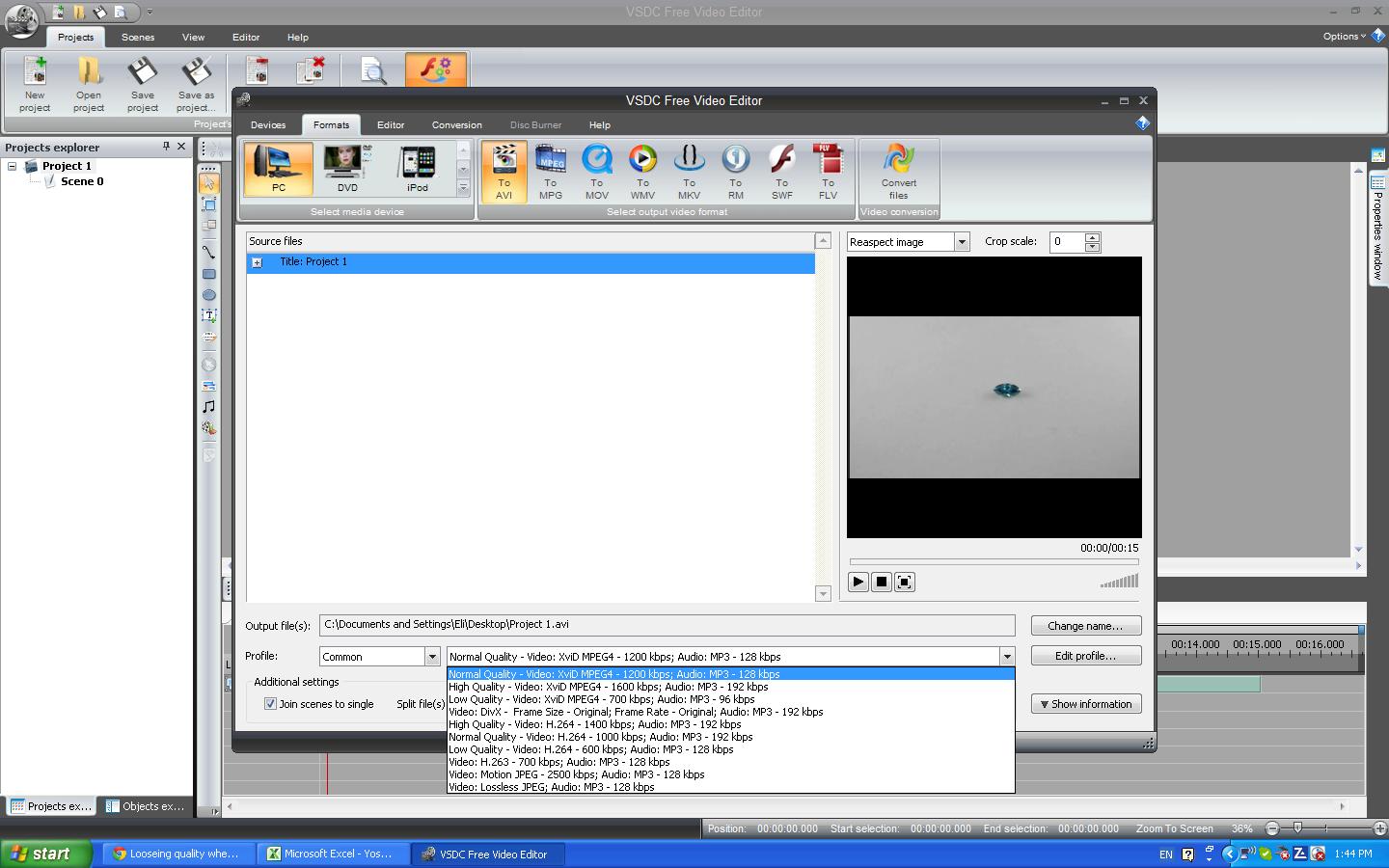

  17. here are the menu options

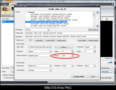

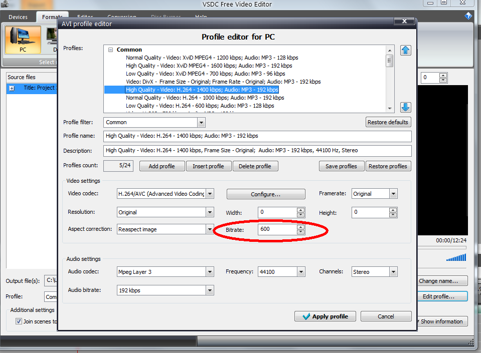

  18. I'm a MEGA Super Moderator Baldrick's Avatar
    Have you tried high quality video h.264 1400kbps? But it might still be too low. The 1400 kbps is the bitrate part.
    Have you tried click on edit profile? You maybe can adjust all settings there.
  19. What should i make the Bitrate?
  20. I have made the bitrate 10,000 and the video is still "blurry".... any other ideas ?
  21. I'm a MEGA Super Moderator Baldrick's Avatar
    What does it say under resolution? Original?
    Maybe does the cropping mess up the video.
  22. Resolution is HD 1920X108 pixels (16:9)
  23. I'm a MEGA Super Moderator Baldrick's Avatar
    Try set the resolution to 1920x1080 manually in the profile editor.
    But I would consider finding another editor...
