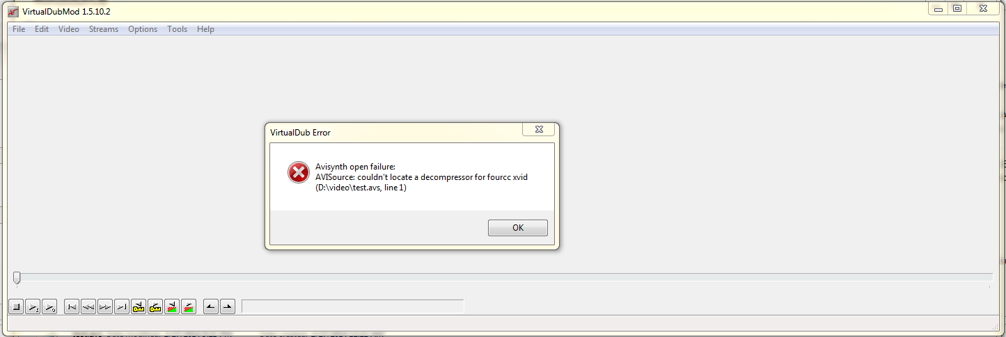

    1. I have Avisynth 2.5 installed
    2. virtualDubMod 1.5.10.2
    My code
    AviSource("test-avi.avi")
ID:	23783Click image for larger version
    I will share the other piece of code as soon as I get the basics right. I guess I m missing something very basic and if I get through that, rest will work automatically.

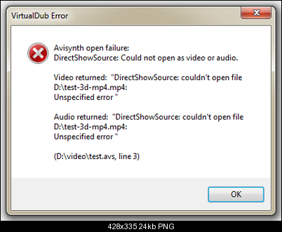

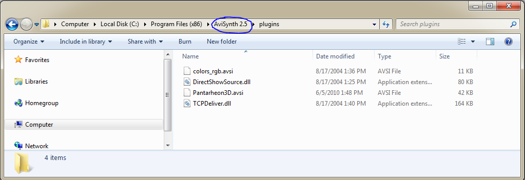

    #ASYNTHER DirectShowSource
    LoadPlugin("C:\Program Files (x86)\AviSynth 2.5\plugins\DirectShowSource.dll")
    DirectShowSource("D:\test-3d-mp4.mp4")
    ConvertToRGB()
    # extract left and right views as separate videos
    left=Crop(0,0,width/2,-0)
    right=Crop(width/2,0,width/2,-0)
    # merge color channels to make an anaglyph image
    r=ShowRed(left)
    g=ShowGreen(right)
    b=ShowBlue(right)
    MergeRGB(r,g,b)
    LanczosResize(1280,720)
    Error I got

    Error#1 should be an easy fix.
    It said right there in the message: Can't find the Xvid codec! Do you have that installed? Not sure? Well, here's a way to find out using a tool that you already have shown you have at your disposal: VirtualdubMod.
    1. Load up in Vdm a file that you already know is viewable/playable.
    2. Go to menuitem |Video|Compression| (aka Ctrl+P)
    3. Look near the end of the list: you should see "Xvid Mpeg4" listed among the codecs
    If it isn't listed, download & install the Xvid codec (there are links from here).
    If it IS listed, uninstall & then properly reinstall it.
    That should take care of Error#1.
    Note that for AVISynth to properly use a media file/stream, it must have 2 things properly installed: a "Source" filter and a Codec (one that is compatible with the source filter's API). Each source filter has its quirks and none work with all codecs. The ffmpegSource, which includes its own codecs, is probably the most all-encompassing.

    Sounds to me like you've got a problem with your DirectshowSource filter (or you *.MP4 files).
    Working on the filter first:
    If you installed a recent copy of AVISynth correctly, you should not even need to explicitly load/link DirectshowSource, as it is a standard internal filter existing in the standard, expected plugins folder.
    WAIT! Are you running Win7/8 x64? You may have some compatibility problems between bit-depth variations in code. IOW, when working in Virtualdub or AVISynth, all the code needs to be 32bit or 64bit. You cannot mix & match. This often crops up when attempting to use certain plugins (ones which only exist at one bit depth). I'm thinking that this might be a major factor in what's going on.
    If the problem were non-compliant MP4 files, we could probably find out using MediaInfo readouts.
    Let us know more,
    <edit>I noticed on the AVISynth wiki page this documentation:
    Windows7 users
    Windows 7 forces its own DirectShow filters for decoding several audio and video formats. Changing their merits or physically removing those filters doesn't help. clsid made the tool "Win7DSFilterTweaker" to change the preferred filters. However new decoders need to be added each time so it's not the perfect solution.
    Don't know if that affects you or not. </edit>

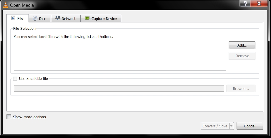

    I have just started playing with this issue recently, and I think I have found a MUCH simpler solution than AviSynth. I'm sure you are familiar with VLC, correct? You can do the entire process right in VLC if you know what you are doing. First, open a SBS 3d video. The picture will be, well, Side-By-Side!! So now you need to view in Anaglyph mode. Go to the "Tools" menu at top of screen and select "Effects and Filters", then select "Video Effects". You will see several tabs...select "Video Effects." Once in this box, you will see "colors", "geometry," "overlay," and several others...you want the one all the way to the right labeled "Advanced." (use the little left/right arrow buttons if necessary to see the "Advanced" menu. In that menu, the very bottom option is "Anaglyph 3D"....check that box. This SHOULD make your SBS 3D video display in red/cyan anaglyph. (I use this feature every time I want to watch a SBS 3D movie in VLC.)
    Now you need to record that output to a file as an anaglyph instead of a SBS. Open the "Media" tab at the top of the screen. Select "Convert/Save." You will get a box titled "Open Media." Select "Add" and you will be prompted to choose the input file...select the SBS file that is already open in VLC) Once the file is added, look to the bottom of the dialogue box and you will see a "Convert/Save" button. Click that button. Now you have some choices to make regarding the video and audio format of the output file. Every time I have done this I use the default profile: "Video - H.264 + MP3 (MP4)" You can, however, experiment with different profiles or even create your own, but the default seems to be the best and results in the smallest file size while maintaining good quality. (There are even profiles for various smartphones) You will see that a "Convert" box is already selected for you. Another option is to "Display the Output"...I don't recommend this as it may slow down the conversion process. If you KNOW the file is interlaced, there is a box to check if you want to deinterlace (I don't recommend this) Nor do I recommend the final option in that box: "Dump Raw Input." Now this is VERY IMPORTANT: The final line in this box is "Destination File"...YOU MUST ENTER A NAME FOR YOUR OUTPUT FILE HERE INCLUDING THE EXTENSION (ie "testrun.MP4") Many times this is overlooked and you end up with a complete GOOSE EGG after waiting all that time converting. And yes, one big drawback to this method is that VLC essentially has to play the entire movie to convert it. So a 2 hour flik will take 2 hours to convert. And one more thing: Once you have converted your entire movie, you may want to test it out using VLC; just remember that you previously turned ON 3d anaglyph from the "Tools-->Effects and Filters-->Video Effects-->Advanced" menu....you MUST turn it back OFF to view your new anaglyph movie or it will show the movie as a "double anaglyph," which is impossible to watch with or without red/blue glasses!
    Hope someone finds this helpful. I worked on this problem for weeks so that I could watch 3D movies (anaglyph ones) with my red/blue glasses on my 62 inch NON-3D TV. This IS the simplest solution I have found so far; no avisynth or scripts or any such multi-layered processes....all you need is a SBS version of a movie and VLC. (and of course those ever-present red/blue glasses!) If anyone needs help with this process, feel free to email me: chad13075@nc.rr.com
