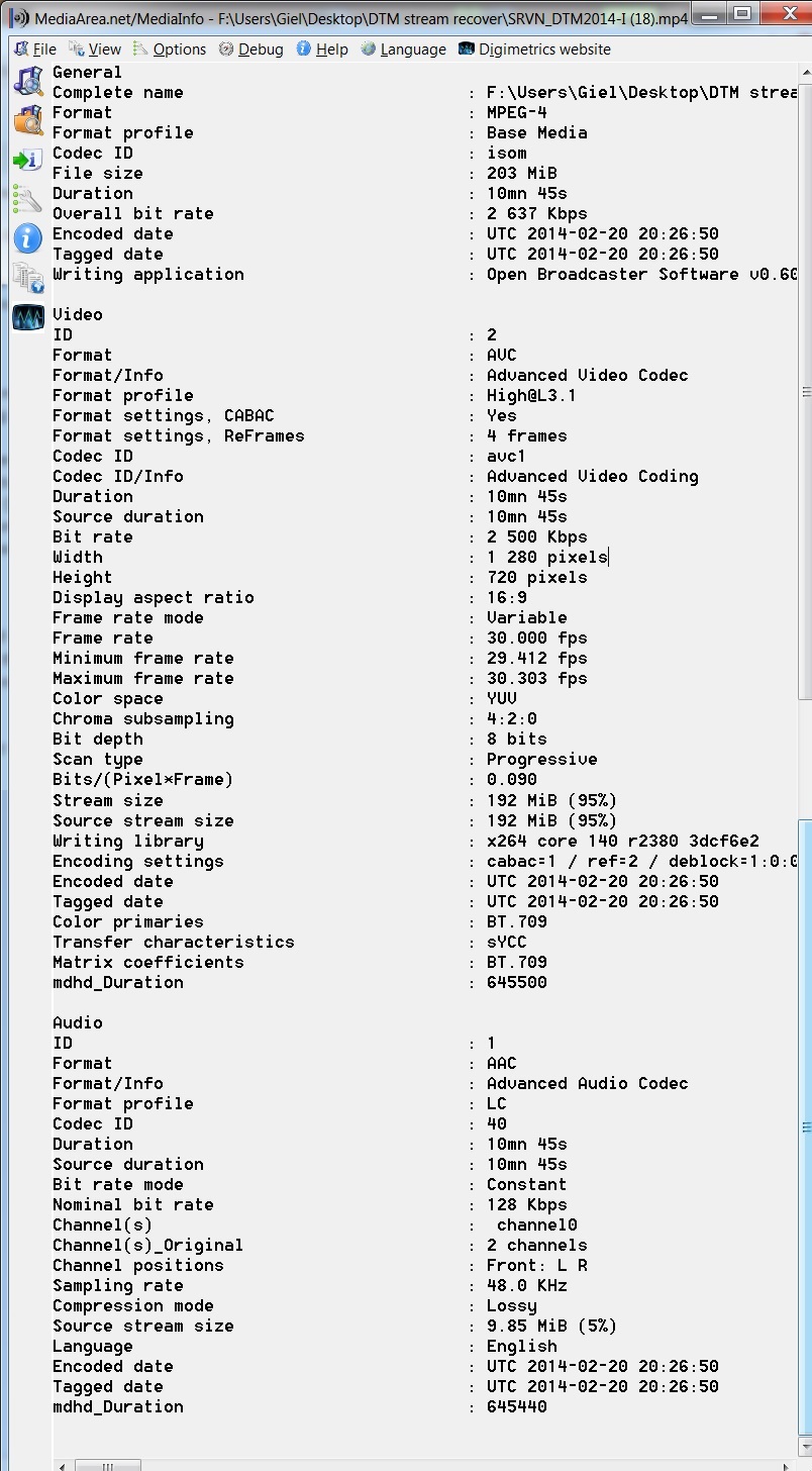

    A mediainfo DETAILED text readout of the GOOD portion would allow us to continue to guide you...
    It's a LOT of work, and nothing is 100% guaranteed, but all is still not lost.

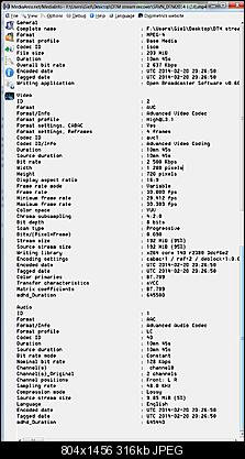

  7. Oh man, not another complicated project... Here is the mediainfo on the second part which plays fine.
    Hope you can point me in the right direction, because i don't have a lot of time to spend on this one.
