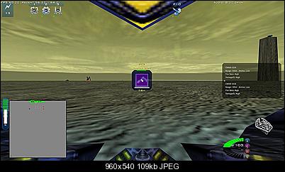

  11. You're not going to get readable text resizing small text like that to a smaller size (notice how there's no small text in your cartoon sample). You can sharpen it a bit by sharpening before and after resizing but that will cause over sharpening halos on all the other sharp edges in the frame. Using AviSynth:
    Sharpen(0.5)
    Spline64Resize(960,540)
    Sharpen(0.5)
    Gives this:
    You can probably come close to that with VirtualDub's Sharpen in Resize filters.
    Game video like yours will not compress as well as cartoons because there's a lot more motion and detail.
    Ont thing you can try: capture with a lossless codec, not MJPEG. That way you'll have less DCT ringing and blocking artifacts, less noise that the final codec will see as detail.
    Sharpen(0.5)
    Sharpen(0.5)
    Gives this:
    [Attachment 23734 - Click to enlarge]
    I did, this was just hq enough for a preview here. As I said, I am working with lossless formats.

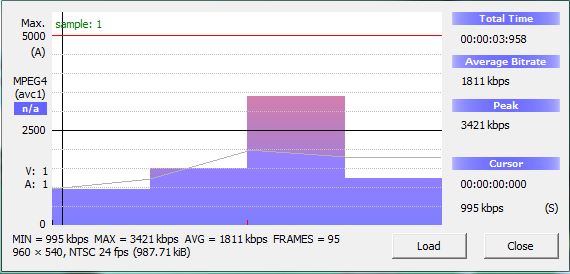

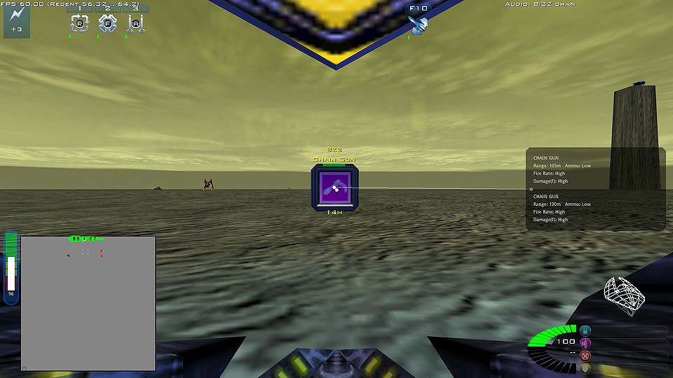

  28. ok, as for that text, look closely at that text for original 1080 mjpeg video, that text shows aliasing, compressed artifacts already,..,so you compress it again, it still looks ok in that resolution you downsample it to, but blown up back tu full HD on screen it shows bad compression ,.., point is, did you check that text as original, it looks bad already
    AND at the same time you get below actual resolution capability for that text size, look at that second time compressed video at that real 960x540 resolution on screen, I had to take glasses and read it from a close up what actually original 1080p resolution says, not mentioning downsampled video, I could read it as well, but sure it is in much worse shape, where fully blown up to 1080p it looks much worse, btw. that text looks much better in my compression, I tried quick in here, but I used CRF 18 which gave me bitrates shown in graph below and LanczososResize(960,540) :
    you perhaps compress it even more

  29. 960x540 here
    I see that 960x540 of yours is mjpeg as well, ...., well either resize is not right or compression is bad, doing both things live, you should capture 1080p and downsample later into mp4, it will look better
    you talk about uncompressed above, as I recall, but you use mjpeg, nothing uncompressed there

  30. Originally Posted by 2mg View Post
    Just for comparison, see my linked video with half the resolution and the pic with newspapers. Incredible difference.
    Even though the frame size is smaller, the text of the newspaper is slightly larger than the text in your half size game video. It also helps that the newspaper text is at a slight angle. It was probably better antialiased than your game text. And the colored background on your text doesn't help. All those things are working against your game video even before you start encoding.
