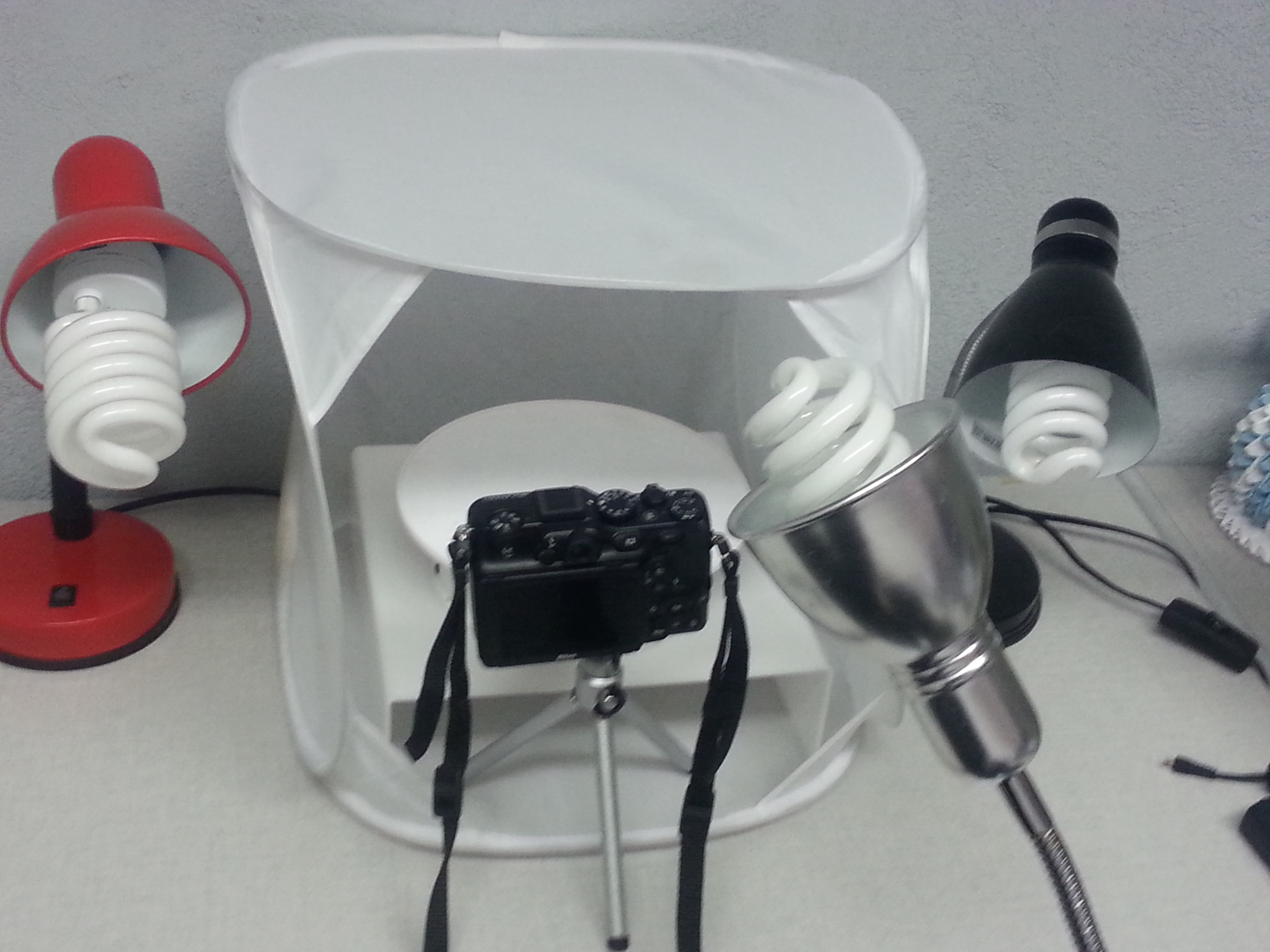

  8. Here is a picture of our setup, any advice on how we can maximize the quality of our pictures ?Click image for larger version
  9. No special trick required, just basic photography. Composition, Exposure, Depth of Field, Controlling your light. Those boxes make the basic lighting very simple, all you really have to do is decide how you want to handle your front lighting -- direct, bounce, flash, none, etc. It will change from subject to subject.
    Your gear is up to the task, now you have to experiment. Start with one light then add another and see what changes.
  10. Are you looking for an "infinite white" background? Your setup isn't right for that.
  11. I would like the background to be as white possible.. what do i need to change for that to happen?
  12. There are many guides at Youtube and elsewhere. Search for "infinite white background" -- assuming that's what you're looking for, not just proper white balance. In short, you need to light the background with brighter lighting than the subject. Then let the camera over expose the background.
