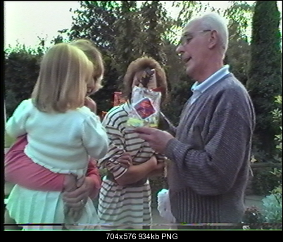

    I've finally taken the plunge and invested in a JVC Super VHS (S-VHS) VCR, an EasyCap (or EZCap) 116 and have put together a workflow of sorts. I'd be really grateful if someone could take a look.
    1. Play VHS from JVC HR-S7611 with Digital TBC (and NR) enabled, BEST on, picture control set to auto, digital 3R on.
    2. Capture using EZCap 116 via s-video and twin phono plugs for audio.
    3. Capture using virtual dub with the settings below.
    Virtual dub settings:
    • Lagarith codec, RBG, multithreading enabled.
    • Video standard Pal I
    • Colour space YUY2
    • Frame rate 25
    • Resolution 704 x 576
    • Luma white point extended so that all data is within blue part of histogram
    • Audtio set to 48000Hz 16bit (in both vdub and windows)
    • Audio uncompressed
    I've got the following concerns:
    1. I couldn't find any reviews of the JVC HR-S7611, but it has TBC so I was happy.
    2. The EZCap 116 is similar sparse on reviews. Some people here say EZCap is good, some say throw it in the bin. I can't get hold of the ATI 600 USB, so how bad is my current setup?
    3. Is this a decent set up for my purposes? I just want to create a good quality backup, uncompressed (for now), of all my old home movies.
    4. I'm capturing at 704x576 as I've read that it's a good idea to oversample interlaced footage. Also, this resolution is exactly double tat of VHS, so I thought it would be a sensible choice when it comes to downsampling it again. (Simple skipping of every other pixel in both directions, no loss of data).
    Here's a sample:
    Here's a sample video:
    https://forum.videohelp.com/attachments/23723-1393167332/Jaydee%20Sample%202.avi
    I've noticed the slight banding (?) at the bottom of the screen. It gets worse if I turn the TBC off, but I can't eliminate it completely.
    So, what do you think? Am I really missing anything, or is this good for my purposes?

  2. If you are planning on filtering in software disable the S-VHS decks noise reduction filter (if you can). Software filters a far superior and the deck's filter is going to mess up the video. I know that on some decks the TBC and NR are locked together so that may not be possible. When that's the case you have to decide which is the lessor evil.
    Since you are capturing YUY2 you should set Lagarith to YUY2 mode. Conversion to RGB will lose precision and can lead to loss of super-blacks and super-brights. Do not use VirtualDub to filter while capturing (it will convert to RGB).
    Capture at 704x756 or 720x576. And leave it at that. PAL VHS has an effective resolution of roughly 350x576 for the luma channel, PAL S-VHS around 480x576.
    A short video sample would be more illuminating.

    In your sample, there's cross-colour artefacts. Are you using the S-video connection? If captured properly, it wouldn't have those fine grained diagonal artefacts in the flower and saturated colour areas. That's from chroma being interpreted as luma. That can't happen with a proper S-video connection, so something is going wrong. It's not on the tape from a previous generation of composite dubbing because the pattern is far too fine. Maybe some EZ-cap setting needs changing?
    Did you turn the TBC off? It looks like it. If so, you should have left it on.
    superwhites are clipped to y=235, whereas there are overexposed parts of the video where it obviously has values higher than this. They're all clipped to 235. You either want to make absolutely sure (using the pre-amp) that everything usable is in-range, and/or allow values higher than 235 through. I've never used an EZcap device so I can't advise on how to do this.
    The tapes seem to be playing back pretty well so hopefully when you've got these capture issues sorted you should be able to get decent results.

  6. Yes, the biggest issue is the herringbone noise. You shouldn't be getting that from an s-video signal and it's very hard to get rid of (without damaging the picture) via filtering. You should concentrate on that first.
  7. Member PuzZLeR's Avatar
    Oct 2006
    Toronto Canada
    There is serious crosstalk going on in the pic. If you can't get rid of it at the capture level, just resize downwards at half the horizontal resolution, and upsize back to the original resolution. If using a lossless codec, results will be better.
    Again, it's always better to eliminate any artifacts at the capture level, and work on that first, like Jagabo says. However, IF all hope is lost (and I stress "IF"), and you capture with herringbone artifacts - there's always Neat Video for processing. With most cases, it's very easy to get rid of, with minimal damage.

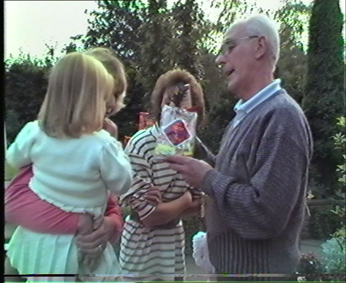

    Ok, this insomnia won't go away unless I take a stab at this.
    Removed the crosstalk for now since it was really bugging me (via downsizing and upsizing as mentioned in my last post). No serious herringbone artifacts in my eyes other than on the red outift the woman is wearing.
    I can give details on how I simmered down the crosstalk, and details as to how to remove the herringbone noise as well, tomorrow if interested.
    Now I can rest a few winks.

    Yep, resizing is about the only way. That herringbone shouldn't be there in the first place. We've had several threads recently
    with VHS captured with budget cards and composite. Same problems in every one of them.
    Brights are so badly clipped, there's no way to get any dynamic range out of it. Levels change every time something moves.
    A nice, decent shot, crippled by autogain. I've said it many times, and I'll say it again: it should be illegal to sell consumer
    cameras with AGC. The best one can do here is control levels during capture to try to rescue some highlights and avoid too
    much clipping. Color tweaked in VirtualDub, but that's a matter of user preference.
    Script attached. HAd this ready yesterday, but the forum download was so slow I fell asleep! Neither PuzZLeR, myself, nor the
    O.P. should have to go through all this work. Need a better capture.

  10. I did this to remove the herringbone and resharpen a bit:
    AviSource("Jaydee Sample 2.avi")
    AssumeTFF()
    BicubicResize(320,576)
    ConvertToYV12(interlaced=true)
    #Sharpen(0.2,0.0)
    QTGMC(preset="fast")
    nnedi3_rpow2(2, cshift="Spline64Resize", fwidth=512, fheight=576)
    Sharpen(0.2,0)
    nnedi3_rpow2(2, cshift="Spline64Resize", fwidth=704, fheight=576)
    Sharpen(0.2,0.0)
    You can play around with those Sharpens if you want something sharper or less sharp. I didn't address any other issues. In fact, I didn't think this was worth addressing since he may be able to get better caps.

  22. Member PuzZLeR's Avatar
    Oct 2006
    Toronto Canada
    @Jagabo: I was curious about a couple of things (like the double upsize, and the sequence, etc.), and this clears things. Your noting was more thorough than I bargained for - thanks!
    @2BDecided: Maybe it's my eyes, but interlaced video on certain displays (that display content deinterlaced at the display level better than content that was deinterlaced at the encoding level) looks so much better.
    We are indeed entering an age though where filters like QTGMC() give us more confidence to archive deinterlaced. However, unless I missed something, wouldn't you need to archive it in a double frame-rate to properly restore interlace down the road? That's like twice the file size. (But I should test this more.)
    Originally Posted by sanlyn
    Never mind. Maybe it's too early in the day and I just didn't read this correctly.
    All I was doing was demonstrating some methods to effectively remove the dotcrawl/crosstalk with very simple filters, and relatively quick processing time. I figure post-processing addicts like us would appreciate that.
    I hate VHS. I always did.
  23. Member PuzZLeR's Avatar
    Oct 2006
    Toronto Canada
    @Jaydee: If still alive, I'm still curious how you get that dot crawl pattern.
    Although the ezcap has no comb filter (or the ATI 600 USB if wishing to get one), your JVC does have one. Sometimes this can be caused by an external TBC, but since you don't have one in the chain, and you're using s-video, this is all moot. I'd say try different settings in your JVC (I prefer the EDIT option as well, and play around with NR/TBC and the Video Stabilizer).
    I only get such artifacts when I have no choice but to use a composite/RCA output only VCR (when my s-video ones DO NOT BEHAVE on a certain tape ).
    It should be better to try to clear this at the capture level, however putting a DVR in the chain to reduce dot crawl kills quality IMO. Since it's easily corrected using a lossless format, it shouldn't be a big deal.
    *NOTE: If anyone is thinking that a JVC S-VHS VCR would behave as a comb filter in passthrough, it WON'T work. It's only effective at the unit's tape playing level.
  24. Originally Posted by PuzZLeR View Post
    Which is why I mentioned he shouldn't be getting this herringbone noise from an s-video source and he needs to look into that first.
  25. Member PuzZLeR's Avatar
    Oct 2006
    Toronto Canada
    Yes indeed. It's just that I went slightly off topic with filtering, so wanted to redeem the thread.
    But, as an aside, is crosstalk/dot crawl synonymous with "herringbone noise"? I thought they were different artifacts, the latter being wavy lines, such as those you may notice on a recording of a bad channel. (I noticed some on the woman's red dress in the clip.) Didn't mean to confuse if so.
    At any rate, I'm starting to think a bad cable is a possibility here.
  26. Originally Posted by PuzZLeR View Post
    In this case it is.
    Yes, herringbone is a wider class that describes any noise that shows up as diagonal or zig-zag lines.
  27. Member PuzZLeR's Avatar
    Oct 2006
    Toronto Canada
    Thanks Jagabo.
    As for the pattern that is definitely in the crosstalk/dot crawl subset, which looks obviously like Y/C leakage, I've become content to just filter it out. Using lossless formats, as well as good software solutions (and a good processor) has made a difference.
    At least I know what's causing it on my end on those specific composite/RCA captures.
    The reason that I haven't bothered too much adding in a comb filter solution to the chain is it is also a pain. Capture devices, such as the ATI 650 and ATI 750 have comb filters, but they are plagued with AGC issues. Worse, the 750 is a bad product IMO for other reasons too.
    Some DVRs have an effective passthrough, but weaken quality. I believe, for those that "work", they recompress/reencode the video along the way, which create other obvious artifacts.
    In this case, or even in the case of the O/P if still wishing to seek a solution at the capture level when the current problem can't be detected, is there anything else anyone can recommend? On my end it's hypothetical, since I've considered it resolved years ago, but I'm just curious if anyone knows of any other solution worth trying today.
  28. Member 2Bdecided's Avatar
    Nov 2007
    I can't say I have a 100% fair way of comparing like-for-like when one variable is the TV's deinterlacing. I do know that de-interlacing, re-interlacing, and then de-interlacing again looks worse on a PC. I also know that the deinterlacing in modern TVs is hugely variable. Sometimes it can be subjectively better than QTGMC though.
    For many lossless formats, yet, twice the size. There's a lot of redundancy in there though which can be exploited.
    I'm not saying deinterlace for archiving. I'm saying that, if you've already deinterlaced properly as part of the restoration process, it's pointless to re-interlace before archiving. I would never ever ever convert true 50i to 25p for archiving. It's got to be 50p or 50i.
    Not in this context. Luma and Chroma are stored separately on VHS and S-VHS. The VCR doesn't have to separate them during playback.
    Cheers,
    David.
  29. Member PuzZLeR's Avatar
    Oct 2006
    Toronto Canada
    It is indeed more subjective than anything, and it would be difficult to compare. Yes, on modern displays anything can happen but likely can be unforgiving. But on older SD TVs, or even with Windows Media Player's default de-interlacer during playback, the DvDs/MPEG-2 streams (after encoding from lossless) just play more smoothly in motion, and crisper in picture quality - with the interlace intact. I know there are some sharpening filters under the hood during playback, but they wouldn't have the same effect with deinterlaced video. Again, it's just my eyes.
    Yes, I agree it's wasteful to re-interlace after such a step. But I do do my best to keep interlacing in the archiving whereever possible to have more choices.
    This is one reason why I asked Jagabo to comment on his script, which deinterlaces. I wanted to actually understand it a bit better, so I can play around with it and keep the interlacing. (Don't tell him. )
    Most restoration processes I use happily keep interlacing. For some, it would be a disaster, which, yes I agree, would be ideal to archive with the interlacing removed.
    Ah, Ok. What is strange though about this process is that the external TBC I use, the AVT-8710, doesn't separate luma/chroma properly from the composite decks I use, unless I'm doing something wrong. However, when inputing a composite signal from the JVC S-VHS deck, there's no problem, or I'm doing something right in this case.
    Go figure. This is why I thought something was done internally in the JVC during playback. (But, like I said, it won't work as a passthrough.)
  30. Member 2Bdecided's Avatar
    Nov 2007
    Sorry, maybe we're talking at cross purposes here. SDTVs can't play progressive material - not 50p or 60p anyway. That would be ED. DVDs certainly don't support it. If you're comparing 50i with 25p (or 60i with 30p), then of course 25p is lacking. It's lacking half the temporal resolution.
    ...but if you're using a composite output, the separate luma and chroma have been put (back) together for the composite output, so are no longer separate. Though they don't overlap with VHS sources because the luma stops around 3MHz. See...
    http://commons.wikimedia.org/wiki/File:S-video_spectrum.png
    ...a) is composite, b) is S-video, and VHS doesn't have any Y/luma above 3MHz so in theory doesn't need S-video. In practice it's safer to use S-video in case other devices don't do the filtering of composite properly (even though the filtering for a VHS source is trivial due to the lack of overlap).
    For all the theory, I'm a great believer in "whatever works" - with the warning that sometimes things look like they're working, but are causing other problems which you notice later.
    Cheers,
    David.
