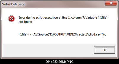

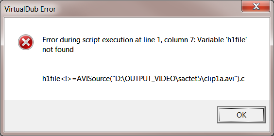

    When I try to run the code below through VirtualDub 1.9.11. I got the error as below.
    h1file=AVISource("D:\OUTPUT_VIDEO\sactet5\clip1a.avi").crop(0,0,-960,0)
    h2file=AVISource("D:\OUTPUT_VIDEO\sactet5\clip1b.avi").crop(960,0,0,0)
    StackHorizontal(h1file,h2file)

  4. It's nothing to do with the script (in principle) but with the paths (I think). Try disabling the audio and make sure both AVIs are in the same folder as the script:
    h1file=AVISource("clip1a.avi",false).crop(0,0,-960,0)
    h2file=AVISource("clip1b.avi",false).crop(960,0,0, 0)
    The AVIs contain the usual kinds of video don't they, and nothing odd like x264?

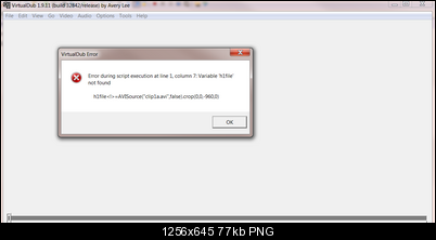

    I'm not sure what I'm doing wrong. All the code error out when I run script trhough VirtualDub.
  6. since the last example manono posted:
    h1file=hifile.crop(0,0,-960,0)
    h2file=h2file.crop(960,0,0,0)
    has a bunch of typos, I tested:
    left=AviSource("D:\OUTPUT_VIDEO\sactet5\clip1a.avi",false)
    left=left.Crop(0,0,-960,0)
    right=AviSource("D:\OUTPUT_VIDEO\sactet5\clip1b.avi",false)
    right=right.Crop(960,0,0,0)
    StackHorizontal(left,right)
    and it works fine here.
    -> if it doesn't work for you, repost your complete script (inside code-tags)
  7. I now see a '.' that shouldn't be there, and that'll screw it up for sure. But when I open a script in VDub with an extra dot, it specifically warns about it. And I typed an 'i' for a '1'. I apologize, kj1983. Thanks for fixing it, Selur.

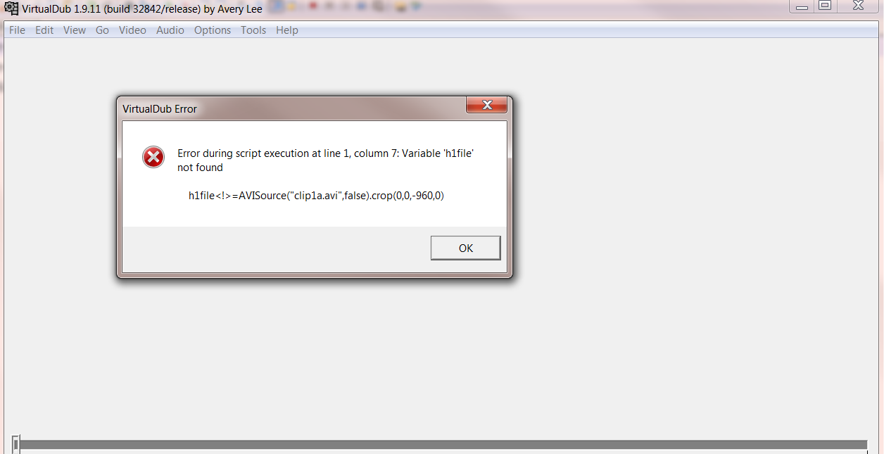

    Jul 2004
    Before, I have fixed 1 to i.
    I'm still getting the error using the code below.
    I used both VirtualDub-1.10.4 & VirtualDub-1.9.11.
    From VirtualDub, File>Run Script (All scripts) and pick sample.avs
    Where sample.avs is as:
  9. From VirtualDub, File>Run Script (All scripts) and pick sample.avs
    LOL,... use: "File->Open video file" instead
    "Run Script" is ment for Virtual Dub scripts (not Avisynth scripts)!
