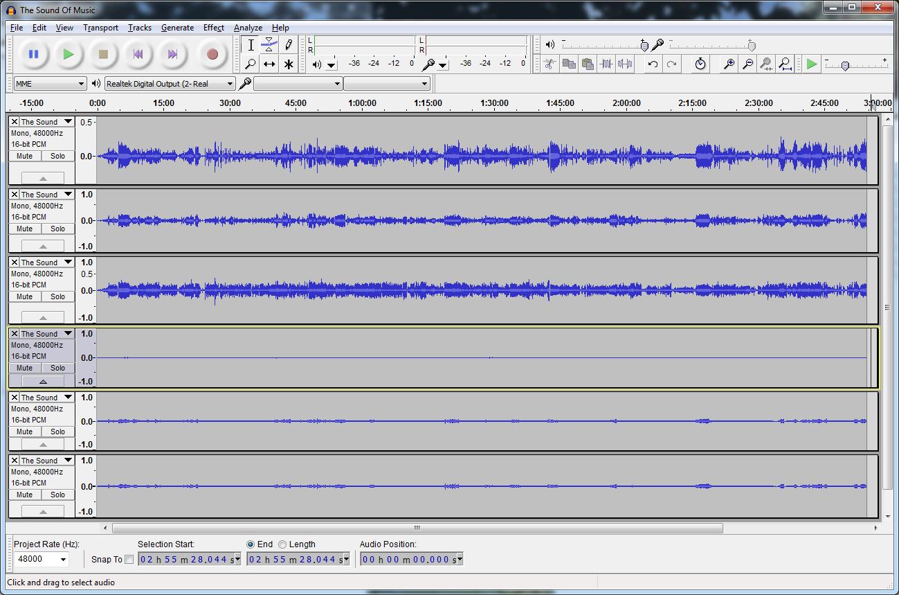

    I apologize. Johns0 is correct that you need to add ffmpeg for Audacity. http://manual.audacityteam.org/o/man/faq_installation_and_plug_ins.html#ffdown
    Then you should have all the 5.1 channels shown.
    The first two channels are the R and L main channels
    The next is the center channel
    Next is the Subwoofer channel
    The last two are the R and L rear surround channels.
    You would first adjust the levels for the channel or channels you want the volume lowered or raised on.
    Then I use 'File>Export' and you should have this. You just need two output channels.

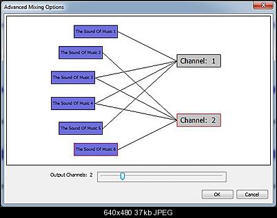

    Then you can mix them like this:
    The R and L channels are put into the new R and L stereo channels.
    The center channel is mixed to both R and L stereo.
    The Sub channel is mixed to both R and L stereo.
    The Rear R channel is mixed to the R stereo.
    The Rear L channel is mixed to the L stereo.
    Hopefully that's correct and proper. It works for me, anyway.
    You should end up with a stereo AC3 mix. I generally do this to a MP3 mix, but it should work the same. Give it a try.
