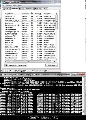

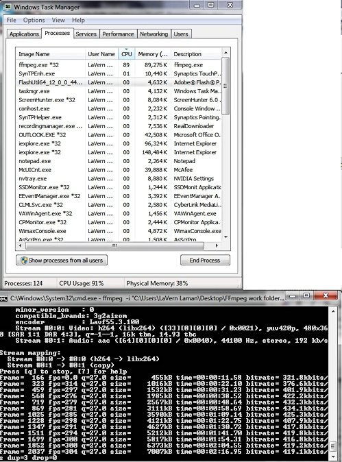

    Have you tried making sure the same video that took 3-4 minutes is the one that takes 30-40 minutes since various codecs and containers, from and to, can cause long conversions as well as versions of ffmpeg. If the same one takes longer then you might try opening the task manager and click cpu usage so the busiest processes are at the top and then run ffmpeg. If it show FFMpeg is using high percentages of CPU usage then it should be fast unless, as Gravitator mentioned, your computer is experiencing huge amounts of retries due to disk or cable problems.
    Looking below you can see 89% usage, @290-300 FPS processing, q=27 so shouldn't slow it down, etc.
Name:	ScreenHunter_28 Feb. 19 11.39.jpg

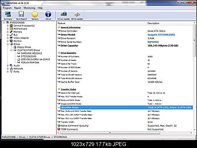

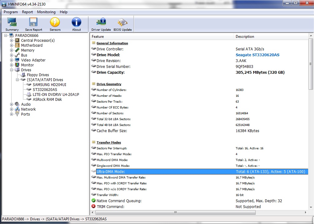

    check operating mode through the utility > http://www.hwinfo.com/download.php
    If the system starts error, then it falls out of DMA to PIO mode - Starts high cpu usage
    It is recommended to change the port to the system reboots drivers/device manager-remove IDE channels and reboot (buy a new SATA cable)
    Do not fill the disk-to-ceiling, disable indexing files on the HDD (if not the system partition), check for broken HDD sector (in the last instance).
