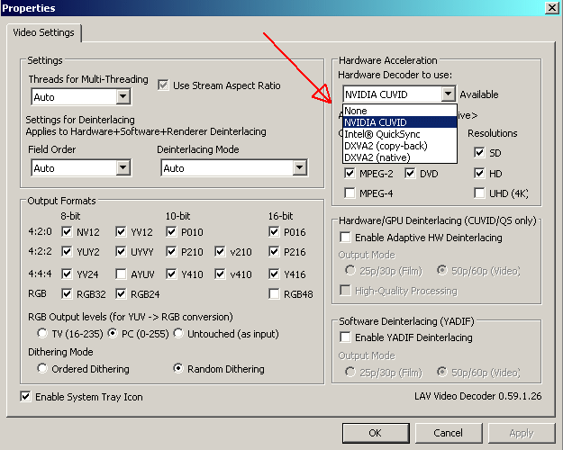

  7. MPC-HC's default settings should mostly be fine. I assume you're referring to MPC-HC and not the old MPC?
    When MPC-HC is using an internal filter it's decoding the video/audio with it's internal decoders. If you deselect one, MPC-HC will then use an appropriate DirectShow decoder if you have one installed. Different flavours of Windows come with different "system' codecs. MPC-HC also allows you to add external codecs directly, effectively bypassing the Windows system for using "system" codecs. There's no need to worry about any of that though. The internal filters are fine.
    Under "Output" I'd select one of the better renderers such as EVR (custom presenter) or WVM9.
    There's an issue with "levels" when playing video using a PC. Video normally uses a limited range of levels (16-235) while computers use a full range (0-255). In order for video to display correctly on a PC monitor, the levels need to be expanded to full range. The same applies to using the VGA input on your TV. When you use the VGA input, the TV is effectively a PC monitor.
    Without going into too much detail, if you find video looks a little "washed out" when displayed on the TV, or if you watch video with black borders encoded but they look dark grey instead of black, the levels need to be fixed. If that's not happening, ignore the last paragraph.
    I don't know anything about Intel QuickSync and which CPU's support it, but maybe go into MPC-HC's options and under Internal Filters, click on the "video decoder" button. In the window which opens, you'll be able to select an option for hardware decoding. If QuickSync is available, hopefully it'll tell you when you select it. Or you might be able to use DXVA2. It's not supported on XP.
