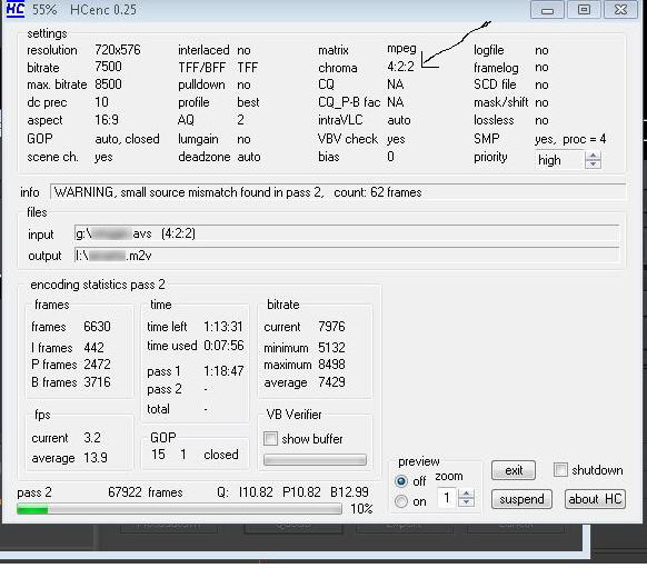

    Mar 2008

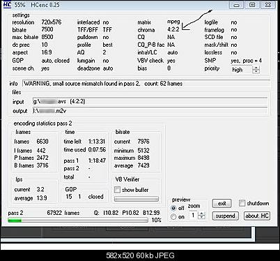

    Originally Posted by avid View Post
    my project in premiere is progressive and the video is 960x720 with 50fps
    Again, 50p is not supported by DVD
    But you need a 50p project to make an interlaced 50 fields per second DVD
    I see chroma 4:2:2 - is this valid for DVD ?
    No, but HCEnc will downsample it properly to 4:2:0, provided the correct interlaced/progressive switches are used
    Yes, but in the image above you can see that 422 is actually selected for the encode.

  4. Originally Posted by davexnet View Post
    [Attachment 23656 - Click to enlarge]
    Then he didn't push the right button. I think "make dvd compliant" will fix it , or fix it in the script

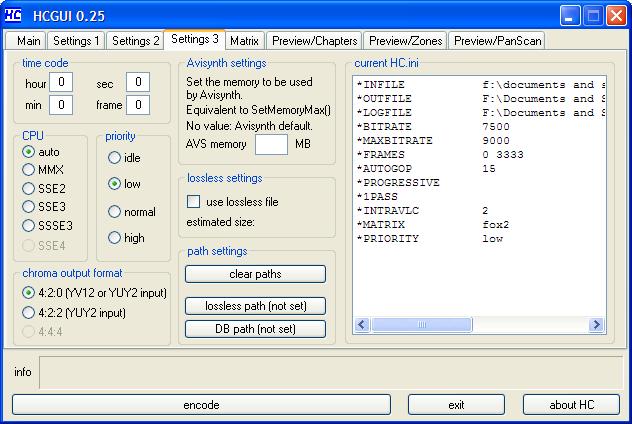

    Mar 2008

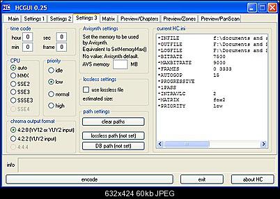

    The setting is here, lower left. DVD compliant button does not fix it.
  6. Originally Posted by davexnet View Post
    The "make DVD compliant" button fixes it in HC026 when feeding 4:2:2 input . But you have to specify interlaced or progressive downsampling, or you get the wrong one and chroma artifacts
    Does HCEnc convert 50p to 50i (25i) correctly ? I don't think so. If not, he should do that in the script, unless he wants a 25p DVD ?
  7. Click image for larger version

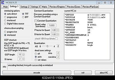

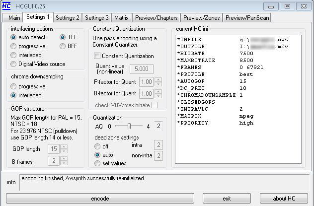

    chroma downsampling interlaced or progressive?
  8. Originally Posted by avid View Post
    Did you decide on what kind of dvd you're making ?
    use interlaced for interlaced dvd
    use progressive for progressive dvd
    For PAL DVD, your only options are 25p (progessive) , or 50i (interlaced) . 50p is not supported . 50i will have smooth motion, but aliasing/deinterlacing artifacts when viewed. 25p will have choppy motion but better picture quality
    You should do those manipulations and resizing in the avs script, along with SD color conversion (Rec601), if frameserving HD intermediate

  26. Originally Posted by pandy View Post
    Spline36resize(720,540).AddBorders(0,18,0,18,color = $000000)
    Why would you do that? Just 720x576 and flag it 16:9 in encoder should be fine. As I understand he has 4:3 anamorphic video, it is 16:9. And any overscan could be a pretty nuisance today.
  27. _Al_ your script is best my output file mpeg is beter now,"interlace" and "BFF NOT TFF with TFF have flickering when move camera.
    i make it from premiere with frame server,(not export avi) and convert the mpeg2 with HCqui for one hour with some effects the HC convert for 4.30 hour,
    audio export from premiere as wav and convert ac3 with TMPGEnc Video Mastering Works 5.
    thanks to all
    PS:What is the shortest for encoding export as avi with lagarith codec and then encode to mpeg2 in HC or TMPGEnc, what do you suggest for faster encoding?
