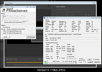

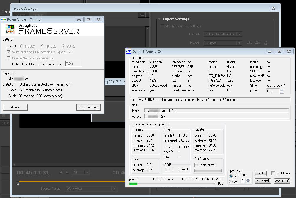

  25. Click image for larger version
    Is there noise in the HD version ?
    What kind of "noise" ?
    What bitrates and settings are you using ? Post your sequence settings, file interpretation settings, render settings
    50p isn't supported by DVD, so it's going to become interlaced 50 fields/second . What kind of deinterlacer is used will partially determine how sharp/blurry it is
    2pas VBR 7500 -8500 this time is rendering is the first test with this encode waiting for 2cd pass
