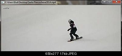

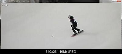

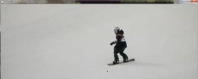

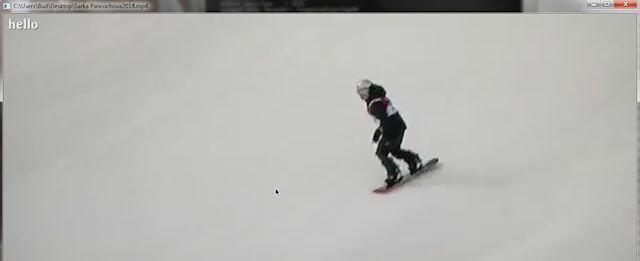

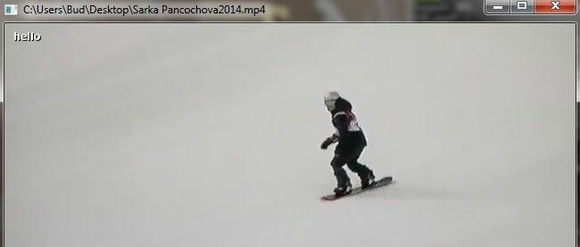

    In the photos below I picked a Font of 15 size that looked good in 640x360 then used the same font in 1280x720 and then 30 Font size with 1280x720. You can see the 30 font (1280x720) and the 15 font (640x360) appear almost the same size. You just need to pick one that looks good at a certain resolution and then adjust per the difference as "New Size = FontSizeyouLiked x NewResolution / ResolutionYouLiked"
    1280x720 Font size 15
    640x360 Font Size 15
    1280x720 Font Size 30 (Image Size reduced by 1/2)

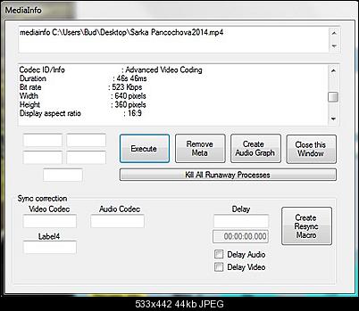

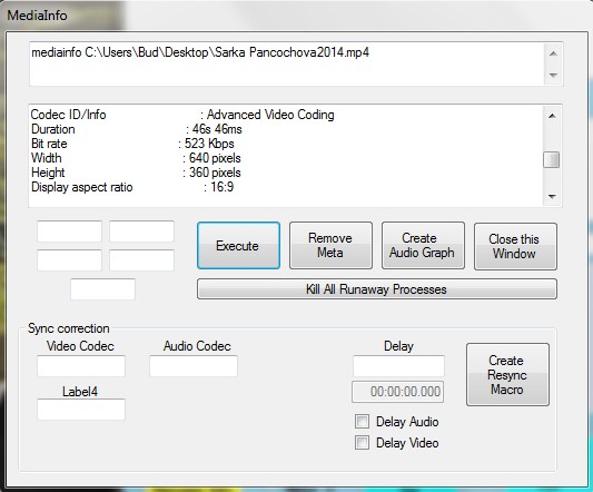

    UPDATE: apparently, after reading more, variables such as main_h, etc. are only used for calculating x and y such as :
    x=(w-text_w)/2:y=(h-text_h-line_h)/2
    So, again, it looks like an intermediate utility or program is needed to interrogate the video characteristics. Font will correctly calculate such as , 'fontsize=15*2'. or 'fontsize=15*1280/640' but without knowing the 640/1280/320/xxx it can't be plugged in unless all the videos are the same size. It is possible but you'd need a program that reads the MediaInfo CLI processes output and then creates the script. Something like :
