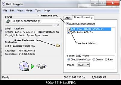

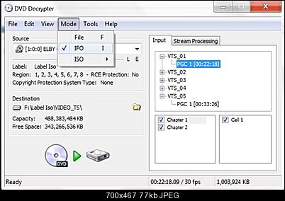

    quick dvd decrypter tutorial for audio only stream processing

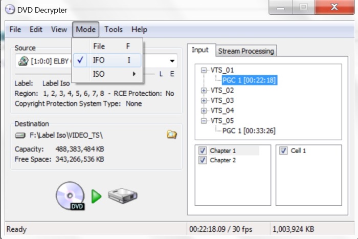

    open Dvd Decrypter...click on Mode...choose File

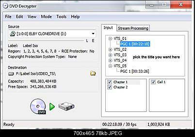

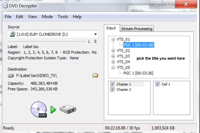

    On the Input tab...choose the file you wanna Demux...It will have the hrs/minutes...duration

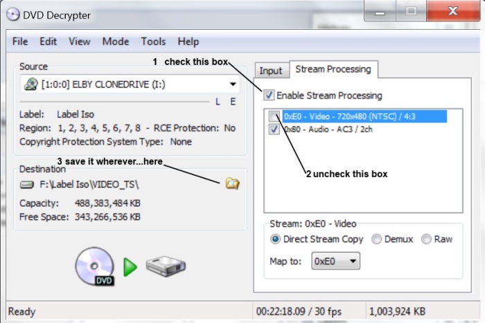

    Check the Enable Stream Processing box
    Uncheck the video portion you don't want..leave the audio box checked
    choose a folder you want to save the audio to
    done

    Great! Thank you so much! One question before I try your quick tutorial. How do I know what title and what file to DeMux? Would I select the longest duration in hrs/minutes?
    [Attachment 23623 - Click to enlarge]
    [Attachment 23624 - Click to enlarge]
    [Attachment 23625 - Click to enlarge]
    done
    Take the VOB's and use PGCdemux to strip the audio from the ifo files.
    Convert the audio with one of the above mentioned apps
    Do you mean click on Mode and choose IFO and not File? You said File but do you mean IFO? And in your screenshot you have IFO selected.
