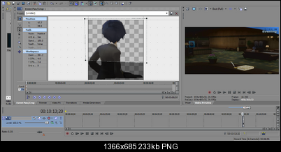

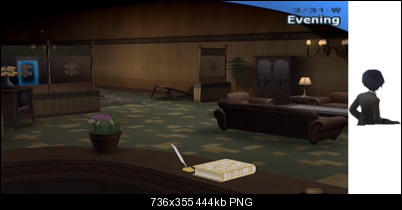

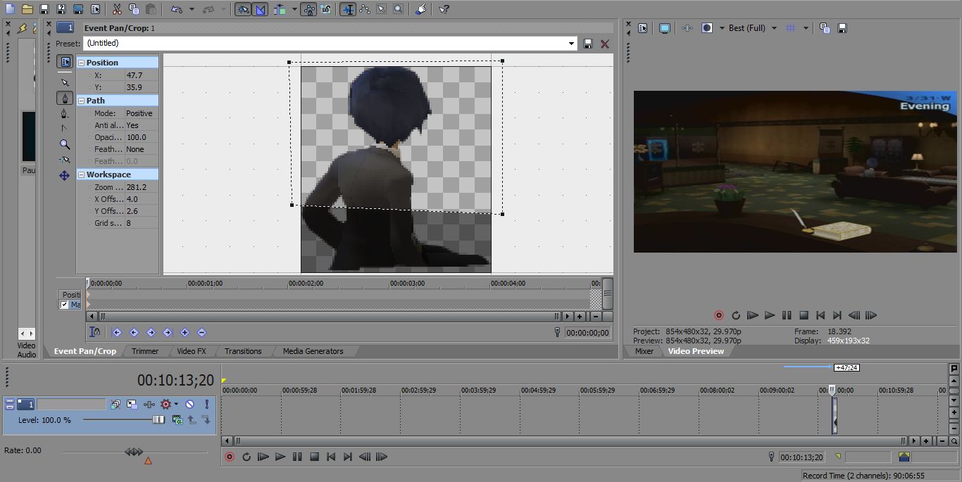

  11. .
    Top screenshot: A scene in the video, and the image to be used.
    Bottom screenshot: The result that I'm going for.
    It would be better if somehow I could see the background, so I could precisely mask the body parts with respect to the surrounding sofa(s).
Name:	Overlay_Mask (Start).png
Name:	Overlay_Mask (Finish).png
    What kind of movement is involved with the camera, and person?
    The scene just zooms out (from the center) a bit and slowly for 3-4 seconds. I had this taken care of with keyframe pan & zoom applied to the image as implied in my previous post.

  12. Originally Posted by Kazuyuki View Post
    If you've already masked out the person - there is no need to do extra work or to see the background in the event pan/crop masking window. Just do a rough mask out the couch & put it on a layer on top to "cover up" parts of the person, then you can fine tune the position for person
    Top Track: copy of the backgound video, but rough mask around the couch to "cover up" the person
    Middle Track: person, positioned to where you want
    Bottom Track: background video
    Video tracks on top "cover up" tracks below
