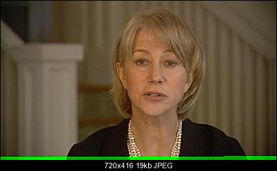

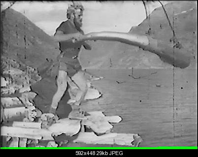

  1. Fairly regular DVD to avi results in a horizontal green line flashing / blinking for some time. It's a bit odd because it doesn't happen all the time but it occurs with stuff from totally different sources. Well, both were NTSC but one is an old VHS tape conversion 4:3 and the other is a DVD rip 16:9. I tried various bitrates and but no luck.
    Examples (it's not there all the time, it's blinking.)
    What I'm hoping for is a way to keep using AutoGK for the time being. Don't say it, eventually I will abandon xvid avi.
    But for now I'd be happy and grateful if anyone could solve this. Ideas?

  2. Is it in your source? You wouldn't normally see it because TVs overscan (you don't see about 5 percent at the edges of the frame).
    Stick with mod 16 frame sizes whenever possible. Never go below mod 4. Some players have problems like that in your samples with less than mod 4.

  4. Originally Posted by jagabo View Post
    No, I checked because assumptions are the mothers of all f-ups, but source video is clear. The colour example comes from a commercial DVD. Three of its items have this when I encode them, the others don't.
    AutoGK only does mod16. The only time I've seen it do something like that is when re-encoding AVIs which are mod2, as it decodes via DirectShow. If the source video is the usual DVD/MPEG2 video though.....
    It might pay to upload a sample of the source video for which you can repeat the problem when encoding.
    Eh, mod4/16? I'm afraid I just bumped my head against the limit of my knowledge. Ouch.

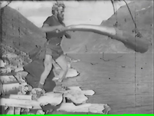

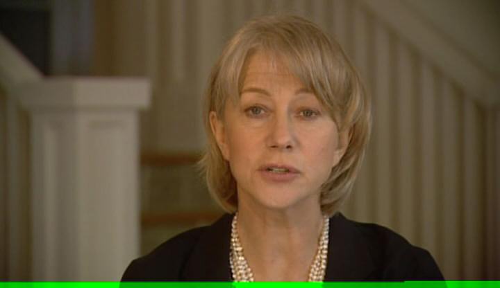

    Anyway here's a bit of one of the videos I was working from (opening titles for an ancient TV series (the end theme is even better)). Hopefully you can find something. Meanwhile I'll try it on another computer.

  5. a source is modX compliant, when it's width and height are evenly dividable by X.
  6. Mod 16 means an integer multiple of 16: 16, 32, 48, 64...
    Both your source (720x480) and AVI file (720x544) have mod 16 frame sizes so the problem must be somewhere else in the processing. Maybe a bad MPEG2 decoder or bad AviSynth or VirtualDub filter.
  7. Seems it is a local problem, it totally disppeared when done on another computer. ???
    This is nøt å signåture.™
  8. I suspect the difference is in the AviSynth filters or version.
  9. Have you installed a different version of Xvid at some stage, or installed something else which might have done so?
    If in doubt, uninstall Xvid and use the AutoGK installer to re-install it. Doing the same for Avisynth might also be a goof idea.
    AutoGK configures Xvid for each encode.... changing settings according to the results of the compression test etc. Generally it can't do it properly when a different version of Xvid is installed, which can result in an encode not looking as good as it should, amongst other things. The "green line" issue you're having might be totally unrelated to the version of Xvid, but anything's possible.
    Have you used the preview function to check the output before encoding? Any lines of green?
    Edit: A few minutes after submitting this post my brain caught up with my typing and it occurred to me to check the AVI sample you uploaded. The writing library is listed by MediaInfo as "XviD 1.2.1 (UTC 2008-12-04)" which I'm very certain is the version of Xvid AutoGK installs.
