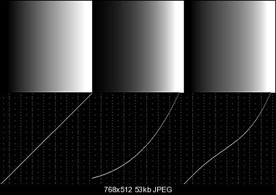

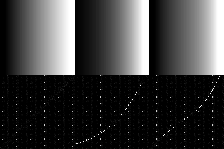

  6. It's just a gamma adjustment, limited mostly to the brighter areas:
    On the left is a (mostly) straight greyscale ramp. In the middle the result of ColorYUV(gain_y=-133, gamma_y=-200, off_y=140), on the right the result of mixing the source and the adjusted image via the alpha mask.
