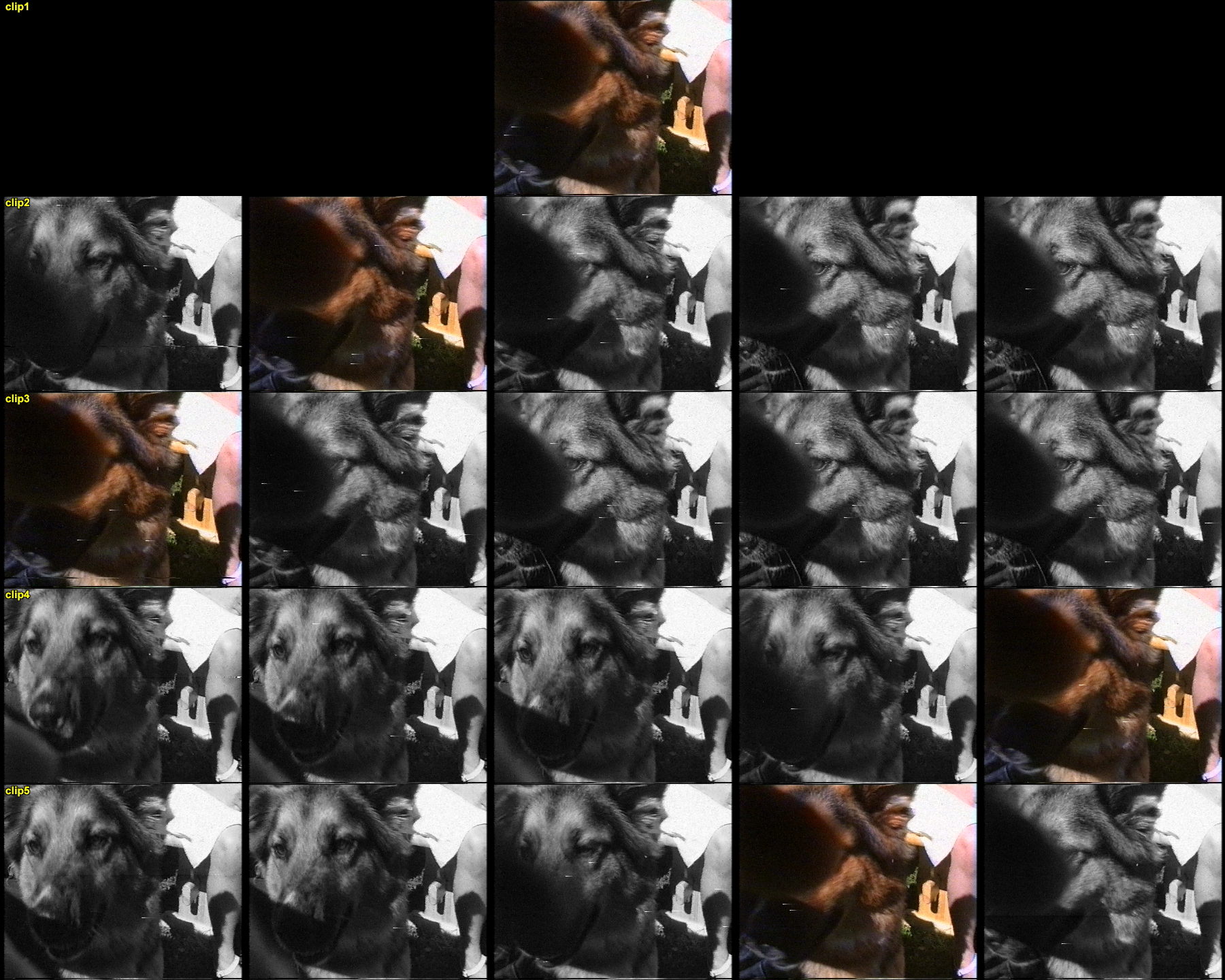

    We can visualize the process by lining up all the streams. I have emphasized the chosen frames by setting all other frames to greyscale. It's a large image so rather than inlining to the post I have attached it separately below. We can see that the correct frames have been found.

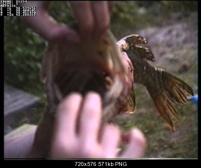

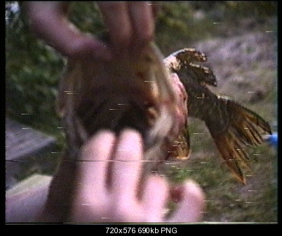

    Using DebugView is a bit cumbersome, so I moved the debug information on the image itself. I also turned the metric around so 100% means exact match. Here is once again an example frame from my troublesome tape:

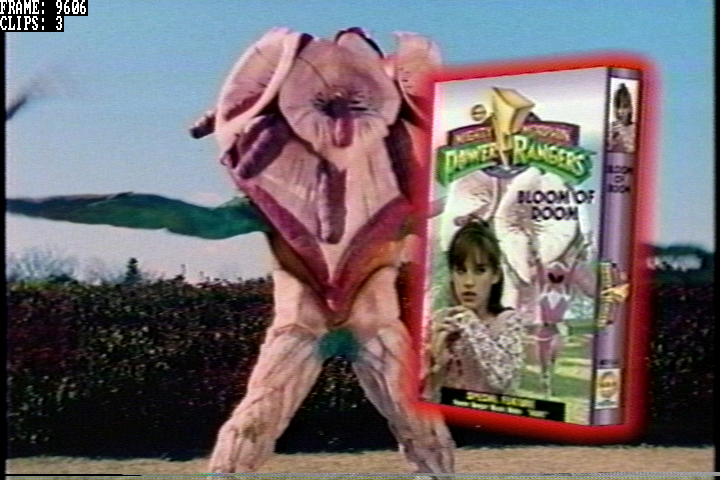

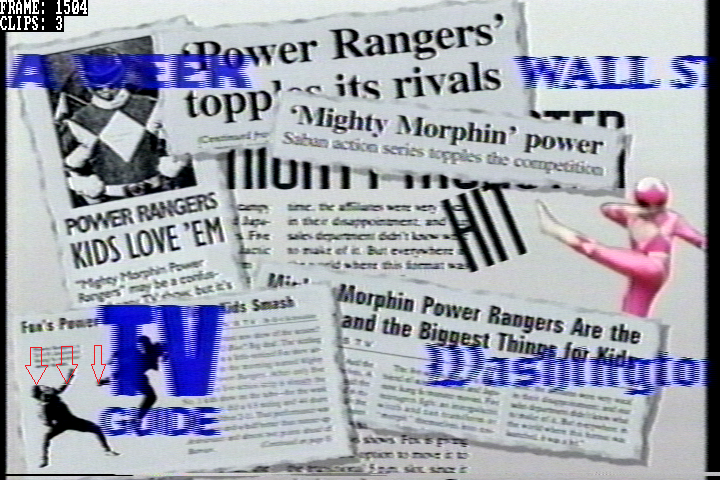

    As we can see, there is a lot of noise and comets on the frame. Let's use the other captures and run Median():
    Median(clip1, clip2, clip3, clip4, clip5, sync = 25)

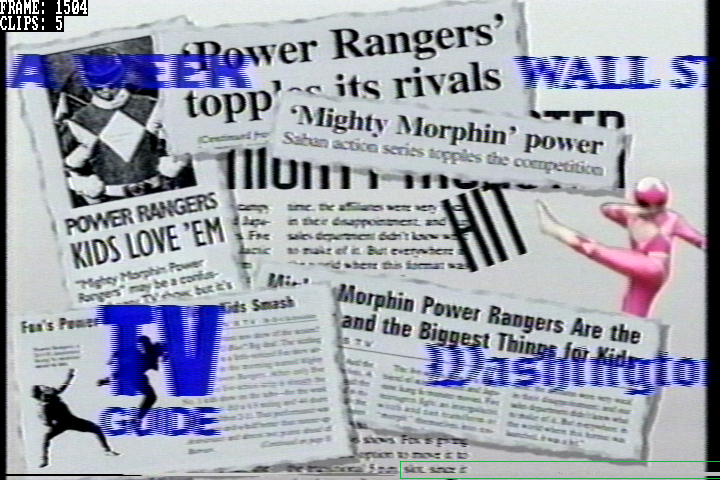

    Not too bad, but looking at the data in the corner we see that near matches have been found for clips 2, 3 and 4, each at over 98% similarity (the other 2% being noise). However, for clip number 5 we get a match with a significantly larger offset and even then only at about 92% similarity. This tells us that most likely clip 5 is not lined up even close, and should be fixed. Alternatively it is possible to increase the sync variable to a high enough value so it will be able to locate the proper frame, but this would slow down the processing further.
    In this case I looked at clip 5 and determined that it is 40 frames off, leaving it outside the search radius. Let's fix this and try again:

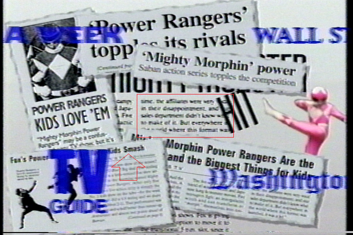

    Median(clip1, clip2, clip3, clip4, clip5.Trim(40,0), sync = 25)
    That's better. Now clip 5 lines up exactly, with an offset of 0. Also the similarity metric matches the other clips. And image-quality wise the end result is slightly cleaner with even less noise and comets.

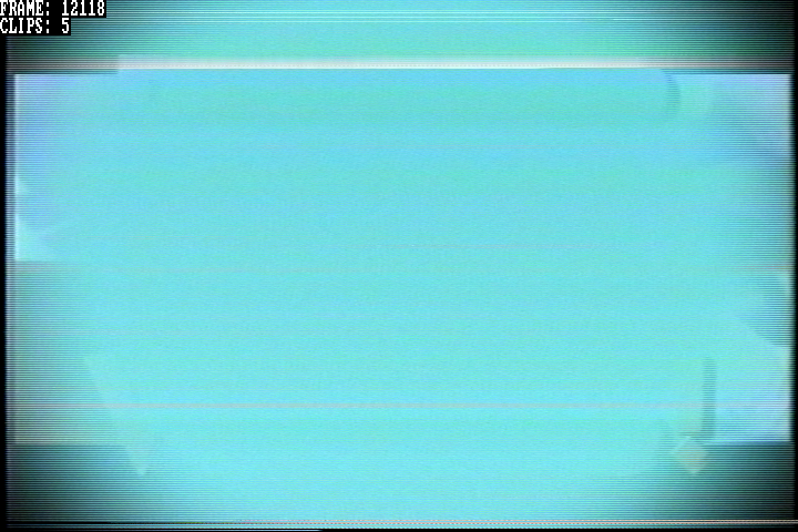

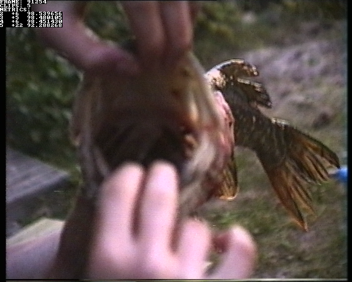

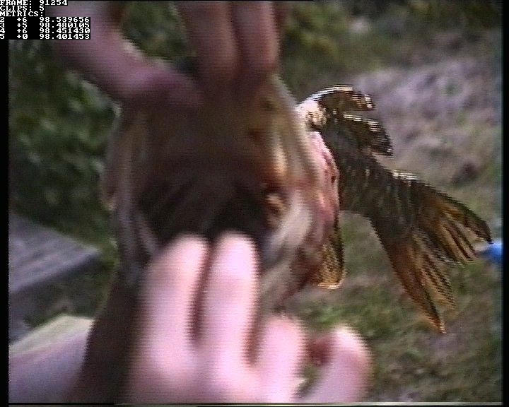

    I bumped the version number up to 0.6. This version now includes the sync functionality to ease the burden of manually aligning clips that may have a dropped frame every now and then.
    Using the feature works as follows:
    Median(clip1,clip2,clip3,clip4,clip5, sync=10, debug=true)
    The sync parameter will determine how far the filter will look for a good match for each frame. A high radius will slow down the processing, so it's good to align at least the starts of the clips manually, with Trim(). Unless you then have a great deal of dropped frames, a radius of 5-10 should be plenty.
    The debug data printed on the image will be useful for determining whether the clips are in sync all the way. Simply jump through different points in your video and look at the numbers. Your debug output might be something like this:
    FRAME: 1425
    CLIPS: 5
    SYNC RADIUS: 5
    SYNC METRICS:
    2  +0  97.384919
    3  +1  97.152746
    4  -2  97.163277
    5  +3  97.213446
    As long as the value in the second column - offset - is always less than the radius, and the third number - similarity - is roughly the same for all clips, things are good. The absolute value of similarity depends on how much difference, or noise, there is between the clips. Once you are satisfied that the clips line up all throughout the video, turn off the debug printout and follow with further processing.
    There is also another parameter, samples, which allows you to choose how many pixels are compared to determine the similarity between images. The default of 4096 samples seems to do a good job without being slow, but you can play around with it if needed.
    I have tested this with a few samples now with good results, and intend to continue on with the rest of my tapes, but any feedback is again welcome!

    Feb 2016
    Lyon, France, Europe, Earth, Sun microsystem, Oracle, in hands of God

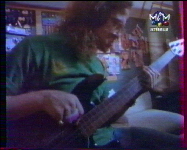

    Well it seems that not reconverting to 25fps after sync of audio is better because differences between number of frames for the same clip decrease
    So I recorded 10 times the same (part of) tape : 5 with a VCR, 5 with another.
    Some duration are very different from the majority.
    Obviously, the tape was bad by itself.

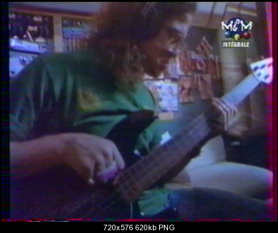

    The reference :

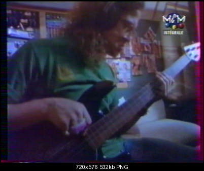

    MedianBlend all records but 1 (the one with the duration most different). Settings : low=2, high=2,sync=100, samples = 414720 (just for try...)
    You can see the logo is blurred
    Median only with all records but 1 (the one with the duration most different). Settings : sync=100, samples = 414720 (just for try...)
    Not that good too, logo also blurred (less than previous)
    If I allow only one frame difference between records :
    MedianBlend 7 records. Settings : low=1, high=1,sync=100, samples = 414720 (just for try...)
    I can't see the difference with the previous MedianBlend
    Median only 7 records. Settings : sync=100, samples = 414720 (just for try...)
    Can't see any difference either
    I'm surprised that the results are not so good. Have you got any clue ? I know I put sync and samples to big values, but I don't see why it could affect the results (quite the reverse).
    EDIT : forgot to say that I use composite. If I use svideo the result is very bad for any cap. But we could give it a try, just for the pleasure of seeing spikes removes by the plugin
    Dec 2005
    Finland

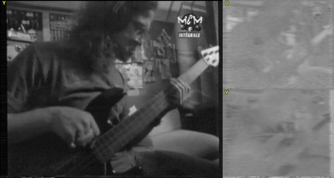

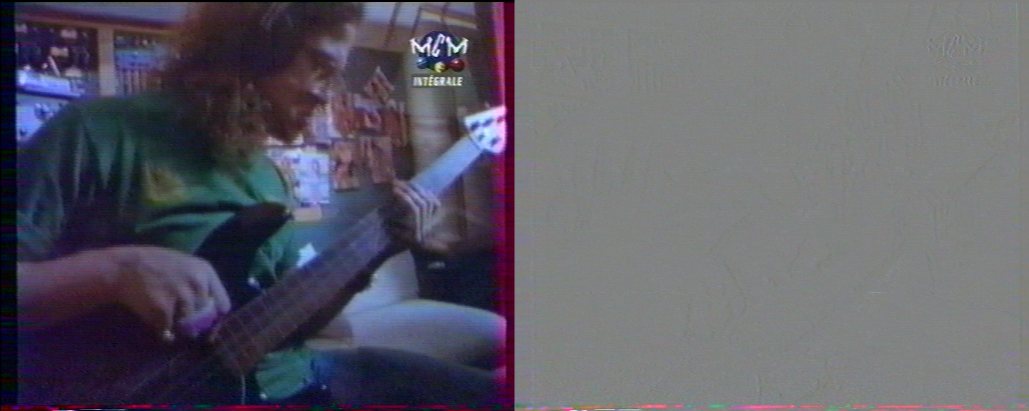

    Thanks for the samples! You can add "debug=true" to see whether the sync is working or not, but I think it is, since usually the result is total garbage if the clips don't match.
    I have attached a few screenshots. In the first one you can see that some noise is certainly being removed, but this tape does not seem to suffer from a lot of dropouts or other such non-repeating issues. If the signal is the same each capture, there are no errors to throw out
    The chroma channels have some odd striping going on, but since they aren't diminished much even after 7 captures, they are probably part of the signal on the tape, not a playback issue. A strong denoise algorithm on the chroma channels could help reduce the rainbow effect.
    Is the colour issue still there with s-video?
  18. Member
    Feb 2016
    Thanks for your quick reply. Thanks also for your examination of my case.
    I've added the debug info and, for the frame concerned, all clips were aligned with the 7 clip version, and -5 or -8 with the 9 clips version. Thanks for the tip !
    Here is an example of what I get with svideo :

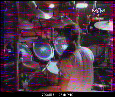

Name:	svideo noise.png
    You can easily understand why I switched to composite I think it's my svideo cable that is wrong but I haven't got an other one.
    I'm not troubled about the noise because it's a test-tape (that I don't fear to play and play again in various old VCR). When I'm sure of my settings, I have a few important tapes to convert.
    Have you got any advice about acquisition parameters and synchronizing the sound (my previous post) ?
    PS : in MedianBlend, there is no warning for even number of clips.
    Dec 2005
    Finland
    Okay... it shouldn't look like that
    I'm not sure about your audio question. The best settings tend to depend on the particular capture device. But it's easy to fix the sync with AudioDelay() as long as it stays constant over the entire capture.
    MedianBlend() can work with any number of clips. It will throw away as many dark and bright pixels as you have chosen, and then average the rest. Depending on your chosen parameters, it can become a median, an average, or something in between.

  23. Formerly 'vaporeon800' Brad's Avatar
    Apr 2001
    Vancouver, Canada

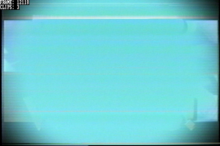

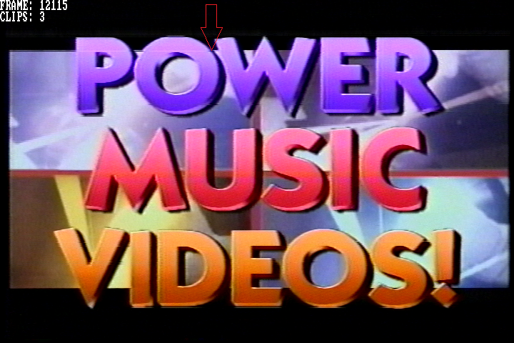

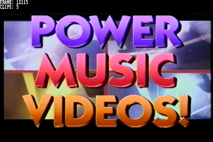

    Some comparisons. The first capture -vs- Median of 3 -vs- Median of 5. Overall, the medians are preferable, but in some cases they add back anomalies that didn't happen to show up in one given capture. The tape used is a relatively good "retail" SP source, but with frequent dropouts.
    Playback chain was: JVC HR-J693U <CVBS> Philips DVDR3575H <HDMI> I forget which HDMI capture card. The choice of using a plain VHS VCR was deliberate, to see the degree to which the Median function can offset the added Y/C crosstalk, etc.
    Here I outlined in green a dropout that was removed only by the median of 5. The head switching area is also cleanest in that one. The color there is almost 100% intact, and it has the least dot crawl.
ID:	36516Click image for larger version
ID:	36504Click image for larger version

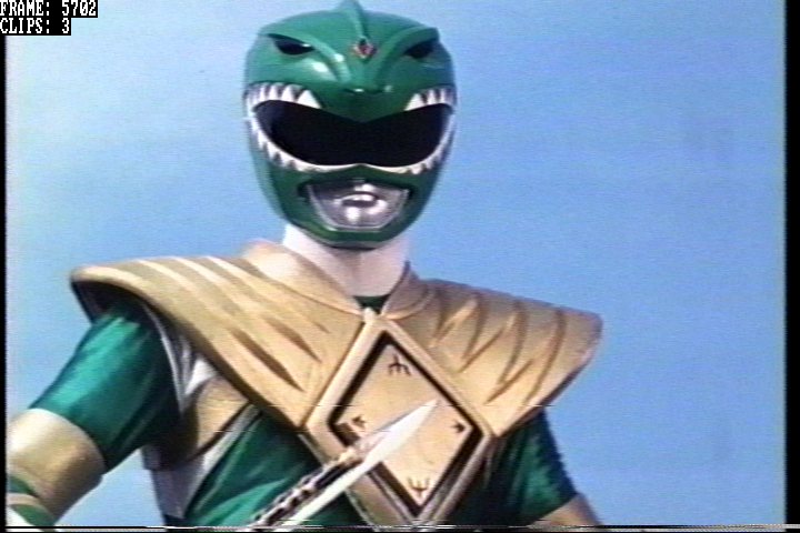

    Here both medians remove some dropouts, but the median of 5 actually looks the worst around the "O" in the "POWER". The first playback happened to perform better than the rest of them in that specific area, so the median function assumed that the more numerous captures were correct.
ID:	36512Click image for larger version
ID:	36511Click image for larger version
    Outlined in red is Y/C crosstalk. Diminished with the medians. But both medians contain a dropout that doesn't show itself in the first capture. The bottom-right edge is cleanest with 5.
ID:	36510Click image for larger version
ID:	36507Click image for larger version

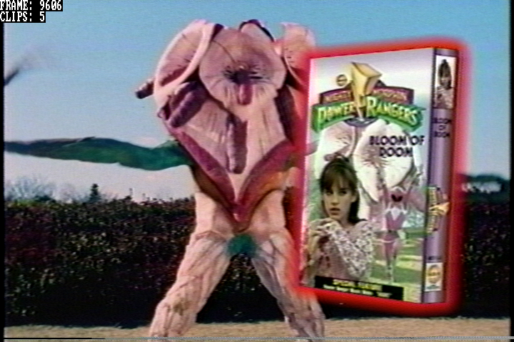

    There were some brightness inconsistencies between the captures. Here you can see that the first capture is brighter than either median on this particular scene.
ID:	36518Click image for larger version
ID:	36515Click image for larger version
