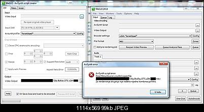

    1. I use eac3to I succesfully demux the files.
    2. Open the source file using MeGUI (DirectShow Source), set resize to 720 : 432 (according to the math formula: 1024/aspect ratio), add command line AddBorders(0,72,0,72) to achieve the desired AR, save AVS Script, exit MeGUI...
    3. Open .avs file in HCgui, set what needs to be set and click on Encode.
    4. When HCgui finishes with creating the .m2v file I can immediately see that the aspect ratio is way off: the video is stretched! And that's the problem.

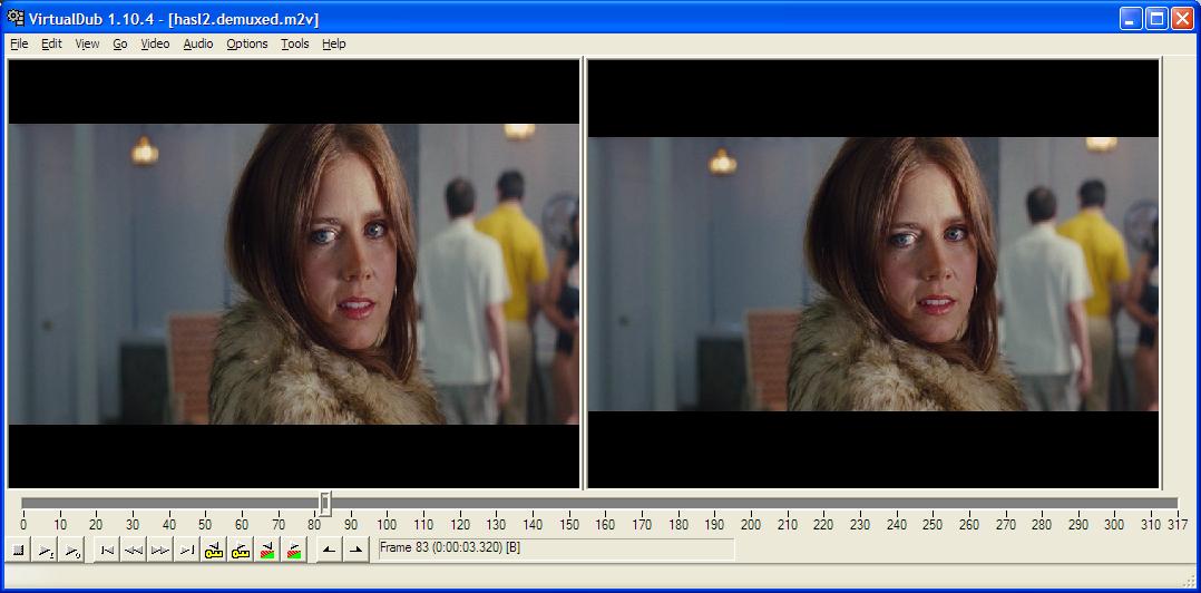

  10. Your M2V wasn't made using only that script above. By my reckoning there are 128 rows of pixels added both above and below, not 72. Did you accidentally have MeGUI add more black and do another resize?
    Mar 2008
    The other interesting thing is, if you drag and drop that m2v into Virtualdub,
    right click the image and choose aspect ratio 4:3, it looks perfect.
    Coincidence?
  12. You're right. Doing this:
    LanczosResize(720,320)
    AddBorders(0,128,0,128)
    results in a script ready to encode as 4:3. I agree that it's not a coincidence. I don't use MeGUI so I have no idea how this might have happened. Was the earlier script somehow changed for 4:3 encoding, even though the eventual encode was 16:9?

    Well, we have a new twist to the situation!
    Yesterday I have restarted my computer and now when I try to open the forementioned file in MeGUI this error pops up:
Name:	megui error.jpg
    The last line is in Croatian and roughly translated into English it means:
    "No combination of filters have been found for streams rendering." But this error does not occure when I open files with 1.77 or 1.85 AR!
    I don't know if it has anything to do with all this, but I just remembered that all this trouble began shortly after I updated MeGUI!

  30. Member
    Mar 2008
    Looking at it in Virtualdub, and setting the aspect ratio to 4:3, it still looks a little out,
    but not by much (objects looking slightly taller and thinner than they should be).
    On the video tab in the AVStoDVD project, did you select 4:3 ?
