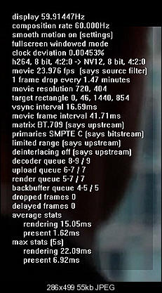

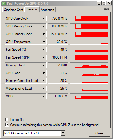

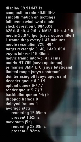

  11. Could be that you GT220 is a bit slow for madVR, or for your madVR settings. You can check that with GPU-Z. Download and run GPU-Z while you play your file. It will show you GPU utilization. You may also want to post screenshot that contains madVR statistics (after playing file for 10-20 seconds) so we can see where where the problem is. Something like this:

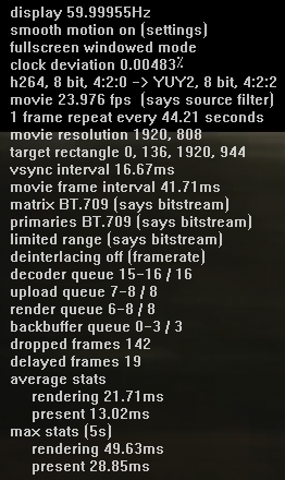

  12. screenshots
    Thanks man for your help
  13. Backbuffer queue is empty. If you did not take this screenshot when video playback was paused, that is the reason for choppy playback. GPU is not weak, 21% load so that is not a problem. Rendering time of 21,71ms confirms that.
    Two questions:
    1. What is your OS and playback setup (player, decoder, version)?
    2 Why is your decoder decodes in YUY2 mod? It should be NV12 for 4:2:0 8bit video.
    Posible solutions:
    1. In madVR settings (accesible during video playback) under rendering - general activate automatic full screen exclusive mod
    2. increase backbuffer for windowed and full screen exclusive mode to 6 or 8 and upload queue to 10-12.

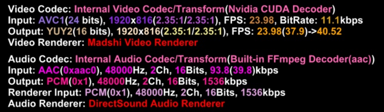

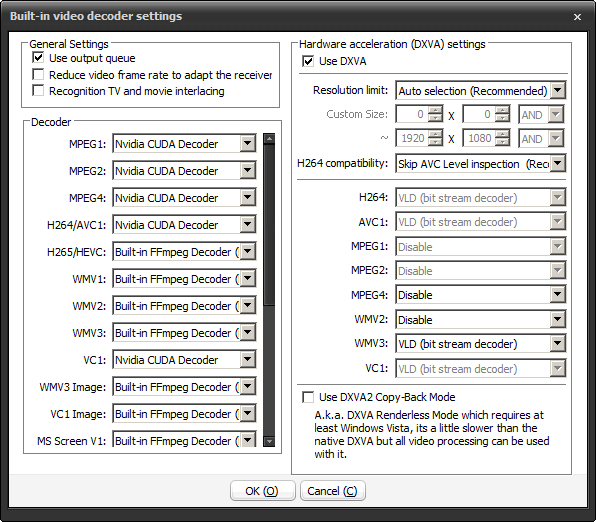

  14. I took screenshot while the video is playing, and i tried solutions and i noticed improvement in the playback. i don't know why it uses YUY2!
    I have Win7 x64, Player: Potplayer 1.5 (32bit) ... More at screenshots

  15. Ah, that's PotP's internal transformation. Anyway, check madVR's stats to see if you still have empty backbuffer and dropped frames. Perhaps some little tweaks of GPU flushes will be needed if you still have problems.

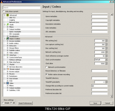

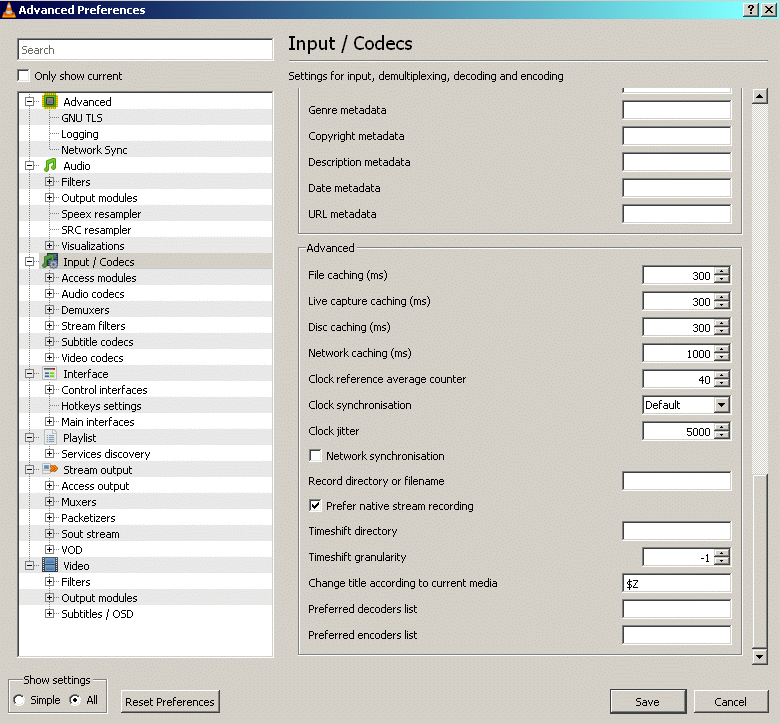

  18. Originally Posted by Hoser Rob View Post
    Try smplayer, go into preferences->performance, set the local file stream cache to 8192Kb. I find this makes an enormous difference.
    Placebo? How does a larger hard drive cache make a difference?
    VLC used to have cache settings, why they stopped I don't know.
    I must have pointed it out a dozen times by now..... they didn't.
    Did you notice performance drop after you thought the settings had been removed?

    Yes, it is normal for backbuffer do disapire in FSE when you use "new rendering path" (present several frames in advance).
    Increasing queue values keeps more decoded frames in memory. Thus, it uses more memory. If you have slower computer it will slow down seeking as more frames need to be decoded when you jump to some frame. But, in theory and sometimes in practice larger queue improves stability of playback.
