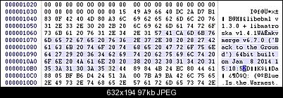

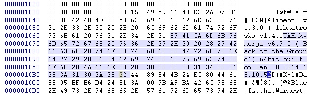

  6. In the ASCII pane you can see the text that MediaInfo (bottom) shows as the writing application. Just replace the text with spaces or whatever other text you want.
    Be sure not to screw up other parts of the file.

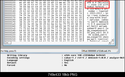

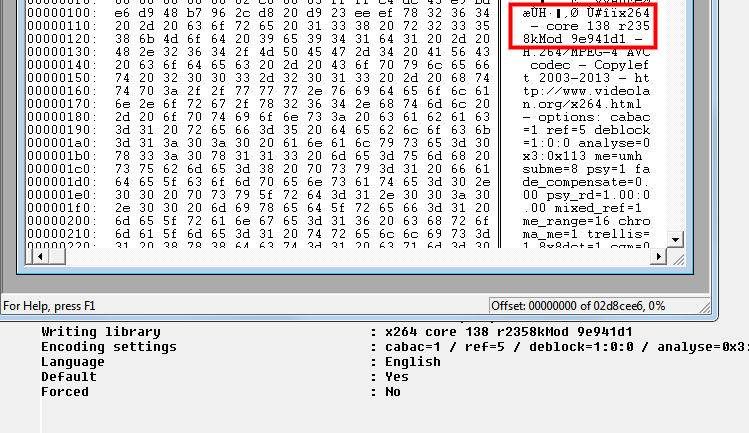

  10. It did work, thanks for your all replies. I filled the information with 00 (select area ASCII then Ctrl-L) in winhex.
