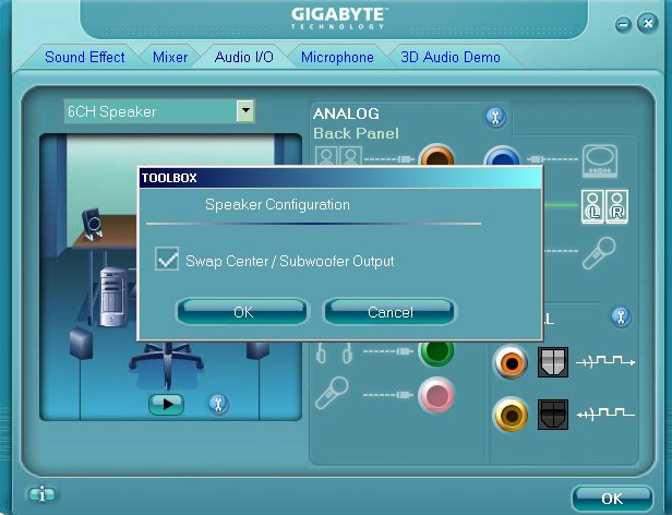

    I don't know how your system is connected, but assuming it's the analogue outputs, if the Realtek sound card works the same way as mine, the centre and sub channels share a single output. They're connected by a stereo plug, but it's sub on one side and centre channel the other (instead of left and right as it'd normally be for a stereo signal). So..... my best guess now.....

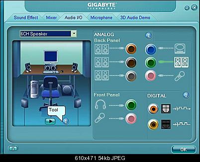

    You don't want to configure MPC-HC to mix down to stereo as I said previously, but you do want to set the soundcard to output 5.1ch (might be labelled as 6ch), and if you're not getting the speech in the centre channel, it's probably being sent to the sub. Hopefully you can tell the soundcard to swap the sub/centre channels and hopefully that'll fix it. Something like this:

    GREATE! Thank you so much. I did switch the center and sub, and now it's played perfectly! thanks again.
