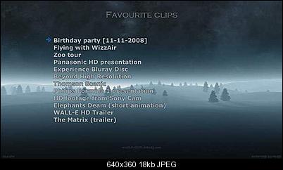

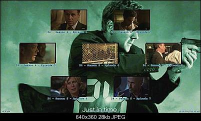

  1. I have been working with MultiAVCHD for a week now, just getting familiar with it. Great tool!
    In this guide... http://multiavchd.deanbg.com/tutorial.php ... it shows a couple menu examples. This guide looks to be created by the author of MultiAVCHD.
    No matter what combinations of options I pick, these two example menus types are never created.
    If only [x] Custom menu is checked your main menu may look like this:: Click image for larger version
    If [x] Thumbnail menu is checked your main menu may look like this:: Click image for larger version
    Can anyone tell me what I am missing? Have these "types" of menus been removed?
    Thanks in advance!

    I think you missed some key words in the description of those screens:
    "If only [x] Custom menu is checked your main menu may look like this:: "
    "If [x] Thumbnail menu is checked your main menu may look like this:: "
  3. I get what your saying, but I doubt that the author was using "word play" to tease an impossible output in his own guide. There'd be no point as the tool is free.
    My point is these screens are clearly NOT creatable through the current interface. For instance, the blue arrow on the "custom menu" above; there are no options for such things within MulitAVCHD, only a generic "square". Also, I cannot find any options to create the round 'clock' shaped "thumbnail menu".
    I appreciate the comment, but I suspect these menu are either created with an older version of MultiAVCHD and their functionality was removed or there is some "external" custom modification of an "MPF" file, not attainable through the interface, to get these results.
    With such a great free tool I am seriously surprised at the lack of guides and information on how to use it at a "more advanced" level. I am very happy there is such a tool and I am very willing to spend all the time I need to know how it works inside and out. I was just hoping if a more advanced user of MultiAVCHD might shed some light on these inconsistencies so I can get past this "wall".
  4. Member racer-x's Avatar
    Mar 2003
    3rd Rock from the Sun
    The 1st screenshot uses "Classic" menu style and was last available (as I know it) in version 3.0, which coincidentally is the one I use because it's the most compatible with my Panasonic BD player.............

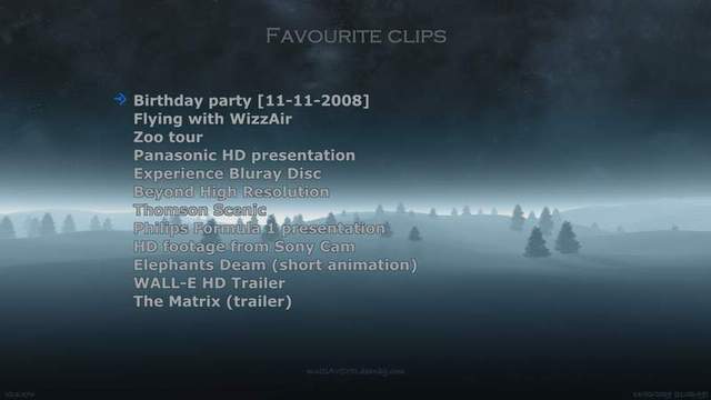

    I actually like version 3.0 with Classic Menus. It's clean and is compatible with every BD player I've come across yet. I also figured out how to replace the lame Splash screen it creates with my own custom 1st play video by editing the created files using CLPINF_Edit.exe
    Here is an example of an old menu screen-cap (resized to 720p) I did a few years ago:

  9. Originally Posted by racer-x View Post
    I also figured out how to replace the lame Splash screen it creates with my own custom 1st play video by editing the created files using CLPINF_Edit.exe ...
    I couldn't find anything on "CLPINF_Edit.exe". Where do you find this tool?
  10. Member racer-x's Avatar
    Mar 2003
    It's been so long, I can't remember where I got it from, so I put everything you need in a zip file. ClipInf_Edit.png will show what you need to do. This assumes you want to replace the lame 30p "01400.m2ts" with your own 24p "01400.m2ts" clip.
