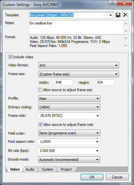

    I am using this setting to render:
    Sony AVC format
    948x534px
    Profile: Main
    Entropy coding: CABAC
    Frame rate: NTSC
    Bit rate: 1000kbps

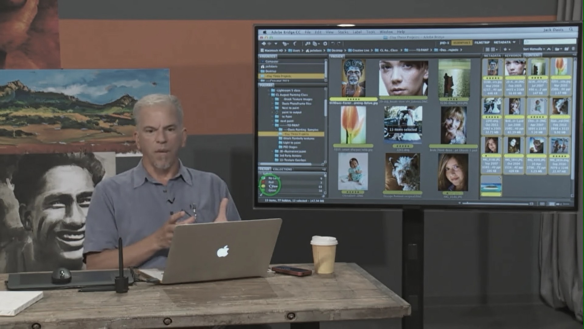

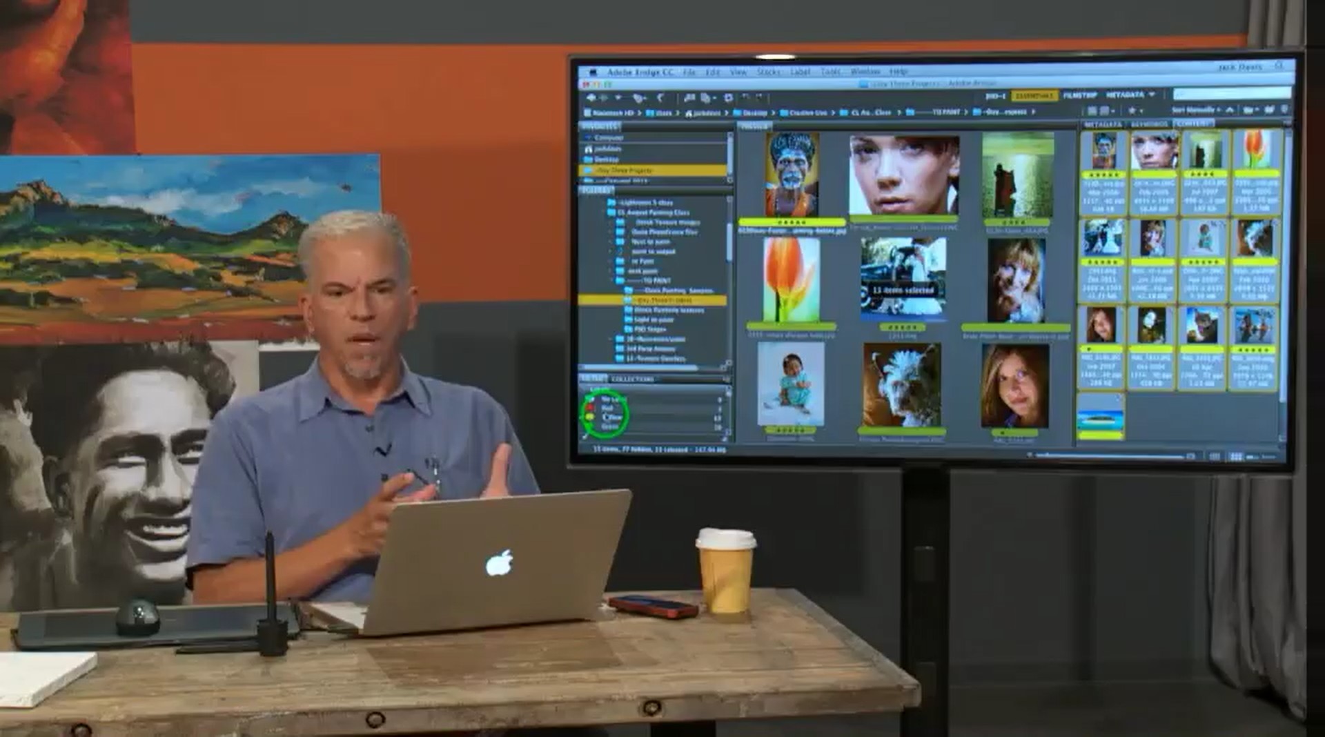

    Hello, I am back with result.
    I have 5 screenshots of video quality with 5 screenshots of render settings plus I will write info about the size.
    I have added it here, but the server messed up the order and did not show filenames, so there it is with filenames and in correct order on google docs: https://drive.google.com/a/fotolukis.cz/folderview?id=0Bw6pZoj-Lxk0TnlwWWE0VDZYTzg&usp=sharing .
    original - 107MB
    AVC - 1mbps (profile high) - 244 MB
    AVC - 1mbps (profile main) - 244 MB
    AVC - 2mbps (profile main) - 419 MB
    x264vfw - 510kbps - 524 MB MB
    x264vfw - CRF 28 - 474 MB
    I discovered, that the "hilarious drop in quality" was not present now (maybe because I rendered it with "ultrafast" setting before vs. now with the slowest one).
    But there is still a color desaturation when using x264 event if I "keep it in original colorspace".
Name:	AVC - 1mbps (profile high) SETTINGS.jpg

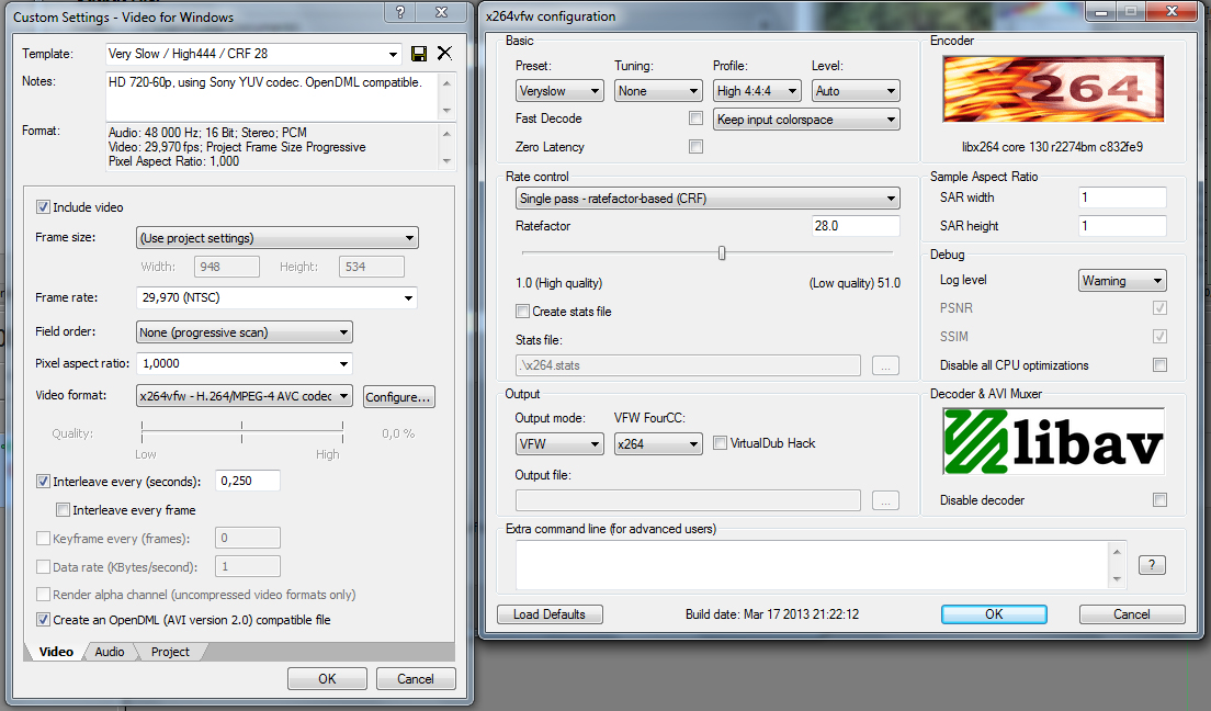

Name:	x264vfw - CRF 28 SETTINGS.jpg

  16. What picture belongs to what settings?
    as for x264vfw, ABR is not good, encode 1pass CRF 18 and to "Extra command line" try to add:
    --vbv-bufsize 800 --vbv-maxrate 500
    if that is not right, go with 2pass 510 kbps average (if 510 is the average you want)
    as for color space, Vegas might do things like that, I cannot see what options are there for color space, ..., is there something with (0,255) ?, expand it back
    also profile should be 4:2:0
  17. Those screenshots show more than just levels issue...

    for _AI_:
    Sorry for the mess in those pictures, but this server is the cause ... hope you find the link to google docs.
    I tried CRF 18 with those commands, but that ended up in quality like other videos, while size went slightly up to 509 MB.
    The other option I chose "Multipass - 1st pass" with 510 kbps (there was no option saying 2pass, so I assumed that one... other Multipass options were: 1st pass (fast) and Nth pass) gave me 410 MB but video track was just pure black
