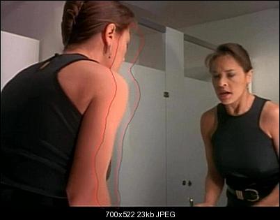

  1. I don't know how it's called, it doesn't look like grain, and I already applied SMDegrain():
    Also offtopic, but what to use to give it also some sharpness? For example the face in the right is really blurry. This image is after applied smdegrain, avs levels, and MSharpen(threshold=1,strength=100), but it doesn't really add any much of sharpness.
    I found out it might be called dotcrawl.

  4. Your issue isn't dot crawl. Your issue is that the chroma (color) signal is delayed (shifted to the right) of the luminance signal. Notice how the color on her arm doesn't go as far as her shirt on the left?
    And degrain filters work by softening (blurring) the image. Of course it looks less sharp.

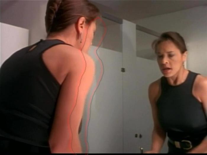

  6. It's both dot craw and chroma shift. A 3d comb filter should help with the dot crawl artifacts (the checkerboard pattern at colored edges). A chroma shift filter can realign the colors with the greyscale image.
    A 3d comb filter requires multiple frames of video. Since I only had one frame to work with I used a blur/sharpen to eliminate the dot craw. That caused blurring of the rest of the picture of course. A proper 3D comb filter wouldn't do that.
    I think I went a little too far with the chroma shift. I shifted chroma left by 6 pixels. 4 or 5 might have been better.
