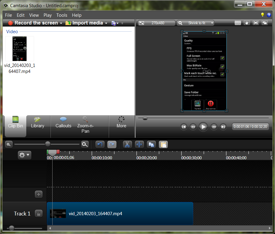

  2. Try copy mp4 files to computer from the Galaxy S3 phone
    them drag copied file from computer to Camtasia Studio
    I have no problem import file to Camtasia Studio
