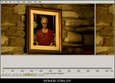

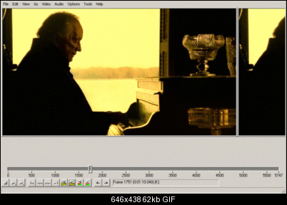

  6. VirtualDub has keyframe buttons on the navigation bar for jumping between keyframes. They're not always where you want them to be but at least you should be able to see where the edits will actually happen. Although the keyframe buttons don't always seem to navigate accurately.... ie the video being displayed isn't necessarily correct.... even when editing Xvid encoded video.
    I'm sure it wasn't always this way..... is there a setting I'm missing? For example, the first screenshot is VirtualDub displaying frame number 1751. Then, after using the keyframe buttons to move back and forth a bit, VirtualDub displays a different frame as 1751. The video in question is an AVI, encoded by AutoGK.
    VirtualDubMod does the same. Maybe it's a decoding problem or the way the video was encoded? I haven't thought about it much until now. Maybe I should try a different version of ffdshow (I don't have Xvid installed so I assume ffdshow is decoding).

  7. Originally Posted by hello_hello View Post
    If I remember correctly, it's a problem with open GOPs combined with unpacked b-frame sequences ("virutaldub hack" in Xvid).
