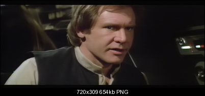

    Here's a snapshot of the capture with the correct Huff version:
    Thanks for the suggestions and advice, I'll take a look at the existing transfers. Even so, I'd still like to learn how to prevent problems in the future because I have a number of films on LD that are unavailable on modern formats.
