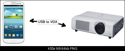

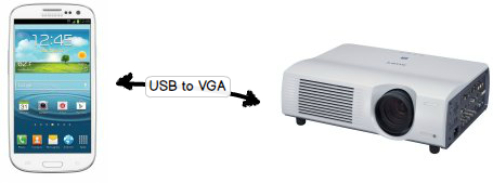

    Incidently, is it a crazy idea to connect either a smartphone or a tablet to a data projector through a USB-to-VGA or USB-to-HDMI cable?

  5. Member yoda313's Avatar
    Jun 2004
    The Animus
    Assuming you have hdmi available you might be better off going with a google chromecast as an intermediate step. They are inexpensive. It would connect via hdmi to your projector - again assuming you have hdmi on it.
    I think there is supposed to be some version of android that works directly with smart tvs by swiping the content from the phone/tablet right to the tv directly. Though I might be thinking of the google chromecast commercials.

    Thanks for the suggestion.
    The idea was that the smartphone/tablet had the AVI and it would simply play from the phone without having to bring a laptop or having an Internet connection.
  7. Member Cornucopia's Avatar
    Many tablets (and a few smartphones) explicitly include a micro-HDMI port. Assuming the device's on-board player can play the media type/codec, can't get much simpler or more direct than that. I have an older pandigital tablet (ugh, yeah, I know I know - I'll be upgrading to a Kindle Fire HDX or similar this year) and even it works great doing this.
