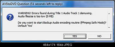

    OK ... run again ... here is the error popup:
Name:	audio too small.jpg
    and the log file:

  15. Ok got the problem. Dave, as many other times, has given the right direction
    The mpg file has the audio MP2 track mapped (very strangely) as track #0:2. When Dave has re-muxed the mpg file, the remuxing step with good old TMPG has corrected the track mapping to #0:1.
    AVStoDVD 2.4.2 did not use streams mapping call when demuxing audio with FFmpeg:
    FFmpeg.exe -i "C:\Input\extract.mpg" -acodec copy "I:\Output\DVD_0_extract_1.ToFix.mp2"
    FFmpeg takes the first available audio track, whatever the track ID is and demux it. That's why DB83 does not see the issue.
    AVStoDVD 2.7.3 uses streams mapping:
    FFmpeg.exe -i "C:\Input\extract.mpg" -acodec copy -map 0:1 "I:\Output\DVD_0_extract_1.ToFix.mp2"
    generating the error by FFmpeg.
    That's an example of combination of badly muxed mpeg2 file and nasty redundancy of command line flags... my bad. From next AVStoDVD release I will add the -map flag only if there are multiple audio tracks in the source file.
    Hence definitive solution is to remux the mpg with a good software (TMPG, Avidemux) and then feed AVStoDVD with the new mpg file. With that workaround also the original big mpg should be properly handled by AVStoDVD.
