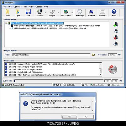

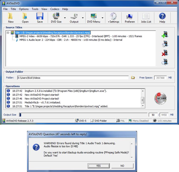

  18. well not sure what I should get .... this time .. my steps
    # Open AVStoDV
    # New Project
    # use + to select file
    (check it was set for DVD folder structure)
    # Press start
    Attached grab show settings & error popup ... this time it complains of zero bite audio ?
    It does this time put output in correct folder .... but in the AUDIO_TS nothing in there
    As Audio is selected and shown in the settings screen should it not have created an Audio file ?
    If I double click the file created it plays - but no audio.

  19. Member DB83's Avatar
    Jul 2007
    Odd. I do notice that two projects are started whereas I would expect one. Try this.
    1. Close down the program
    2. Restart the program
    3. Use title/add title to err um add the title rather than by the + button
    4. Hit start
    Audio_TS is always empty for dvd-video. You do not even need to burn that folder.
    If it still does not work then there must be corruption with the sub-programs. You could try un-installing it and installing an older version. Otherwise I am stumped. But ask on the support thread if the program uses your previously installed version of sub-programs such as mediainfo or its own
  20. Followed those steps ... again get popup that audio is of zero length ... click proceed and it creates file structure shown below ...

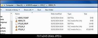

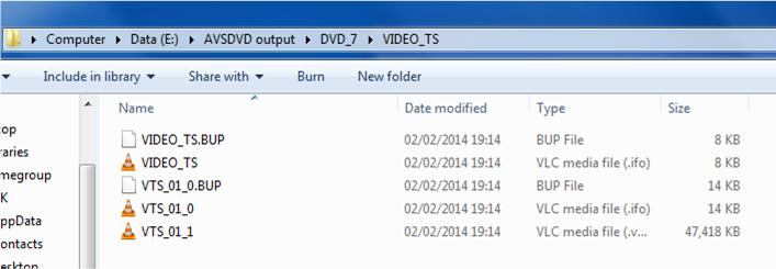

Name:	file struct.jpg
  21. Member DB83's Avatar
    Jul 2007
    Just click (or double-click) on the vts_01_1 file and vlc should play it.
    Tis also wise not to hide file extensions.
  22. Nope ... double click didn't work, I did however open form VLC and video run ... but no Audio
