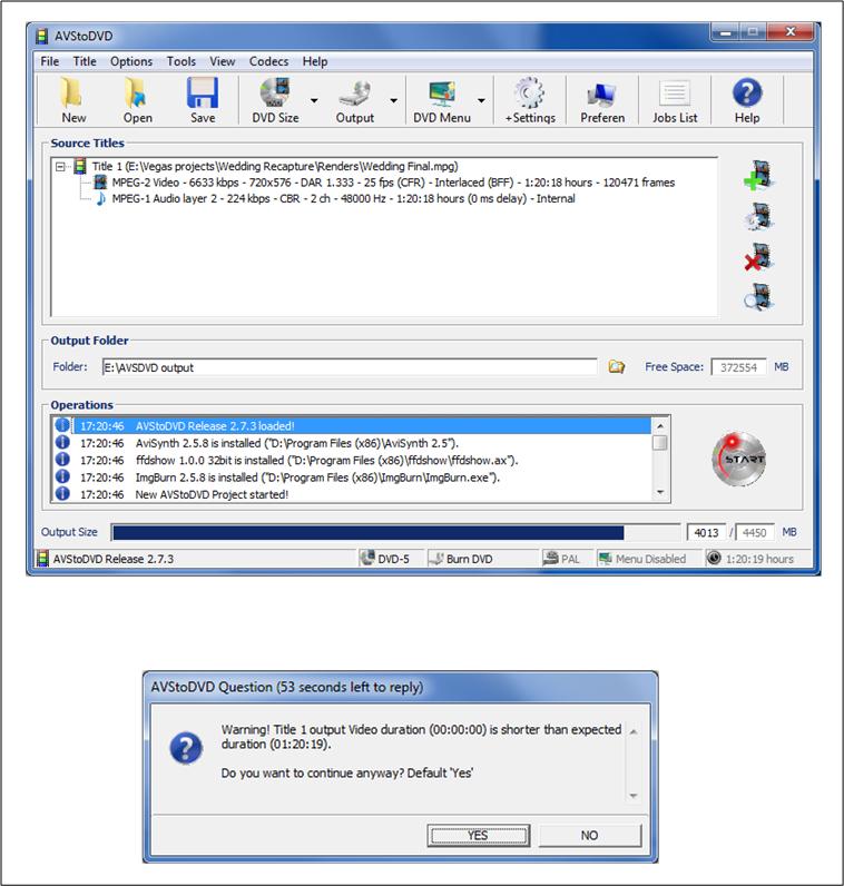

    I started first attempt, set DVD size, pointed it to teh video file ... and clicked start .....

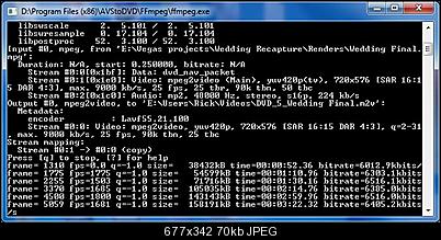

    Now not sure if next bit is correct .... it opened CMD prompt and run ffmeg and many lines of stream information.
    Then it pops up an error saying output duration is (0) shorter than expected duration ...
    The project window is attached - have I missed something out ?

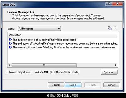

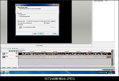

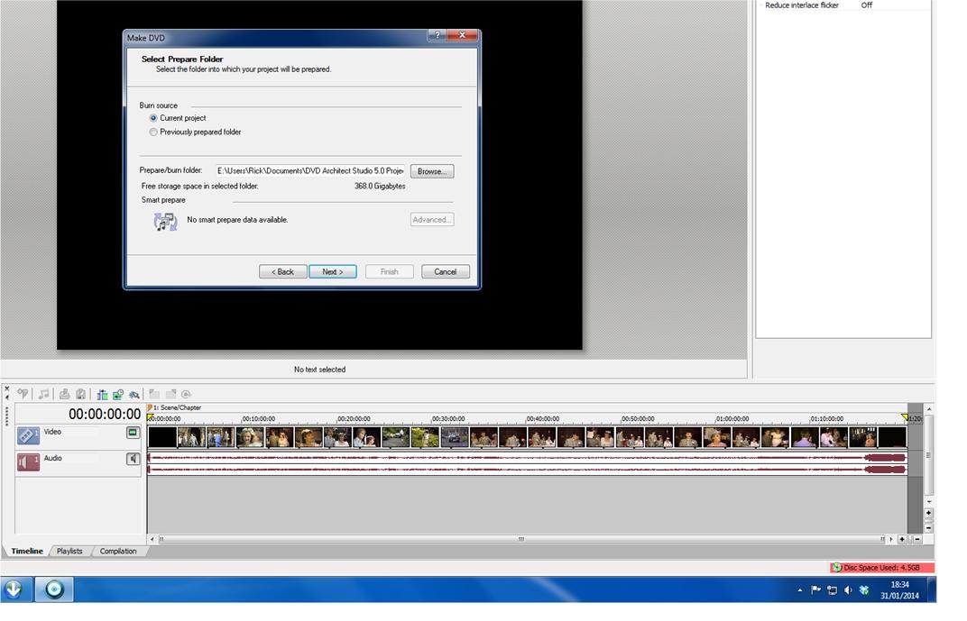

    This was where this started from I have Sony Movie Studio Platinum, suite .... finished creating in Vegas, used teh 'Mke DVD' option, selected form recommended Templates ...
    Used MainConcept PAL, customized to lower VBR peak form 9500 to 9000 and set for 2pass.
    The issue is this should fit on a 4.7Gb DVD ... BitRate calc shows it at well under 4.7Gb .... in the pic below you can see that even DVD architect thiunks it will only be 4.5Gb (bottom right hand corner.:
Name:	arch set up.jpg

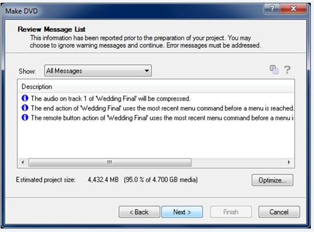

    Yet when I go to next step and choose simple single video, no menus ... .. it gives the follow error :
Name:	DVD arch recompress.jpg
    When I asked this Q I was told not to use DVD architect for simple DVD authoring and hence trying AVStoDVD
    I have always used DVD architect before, works fine - but they have been less than an Hr .. so never hit this issue

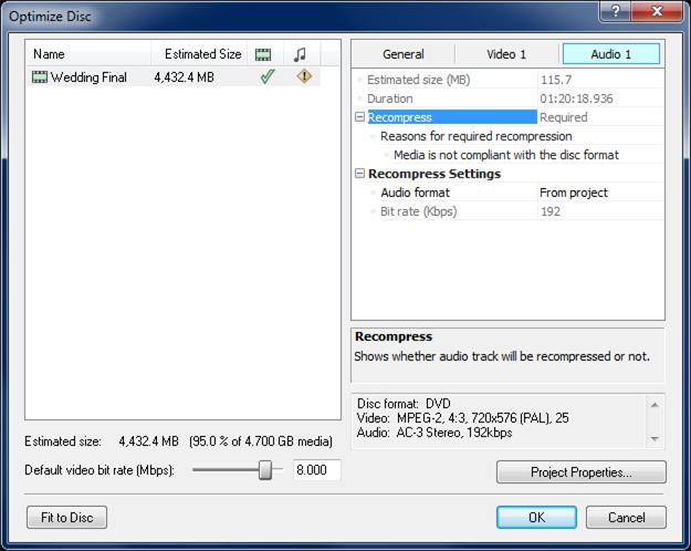

    Getting somewhere now .... I did not use optimize as your initial post on #03 https://forum.videohelp.com/threads/362042-Audio-format-for-DVD?p=2298774#post2298774
    said "Do not let DVD Architect to optimize anything" ... which I thought you meant do not use the optimize button ? (my misunderstanding)

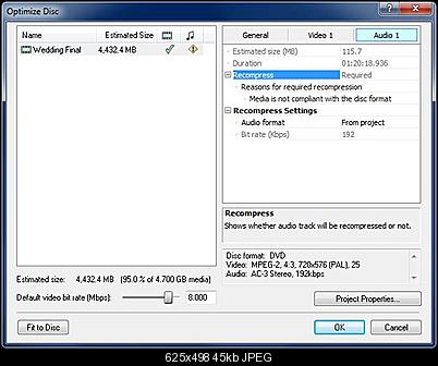

    Now followed your step above and clicked on 'optimize' and can now see the following:
    It looks like it is dropping Kbps down to 192 and it is happy ?
    Is there anything else in these options I should set ?
    So maybe I should go back to using DVD Architect ?
  15. As for that screenshot, it tells you why it does not accept audio, it thinks, it is not DVD complaint, not sure what is going on now, I thing it does not accept mpeg audio, even if it is allowed in PAL country. That is my recollection of things. Is audio AC3 or mpeg1layerII ? Oh I see it now it is AC3,
    so definitively try to lower average video bitrate , maybe there is not enough room on DVD, as far DVD Architect is concern ...
  16. Media info for the file that is dropped into DVD architect is attached.

    I would have thought that any dvd-authoring program worth its salt would accept mp2 audio at 224 kbps 48khz for a PAL dvd and NOT re-encode unless....
    The dvd project properties state that it will create AC3 audio (in this case at 192 kbps but it surely could be higher if required)

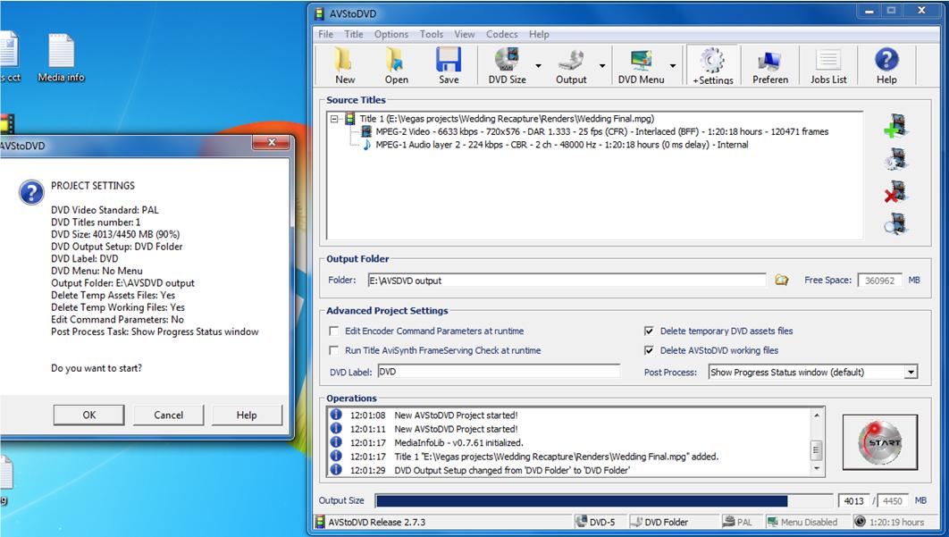

    I open AVSto DVD
    File 'new project'
    Set Output folder path (mid screen)
    Click on Green + to add file (1Hr 20 mpg, embeddded audio)
    It is noted that in bottom RH corner of screen correct duration of video is shown ( 1:20:19 Hr)
    Click on start button

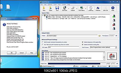

    The following screen opens:

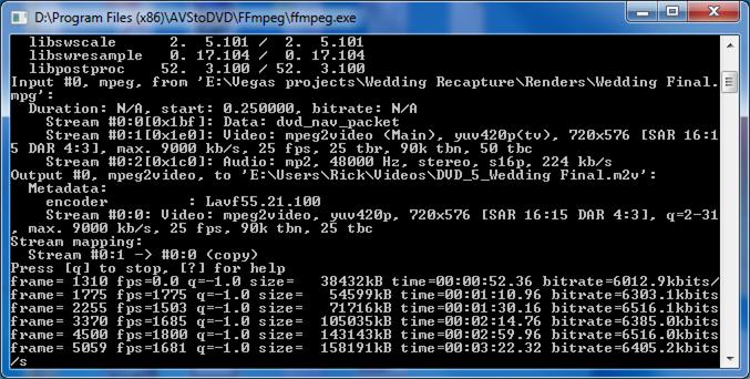

    Then I press OK and cmd prompt opens :
Name:	cmd prompt.jpg
    It runs for a while then I get a popup window posted in post #01 that output is 00:00:00
    Previously I went to View>Operations Log and saved the log from there .. as was only place mentioning 'Log'
    I went to the Output folder as you suggested and have attached the file there
    There are no DVD files in the output folder
