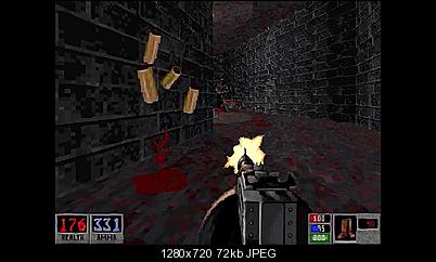

    Hi guys. I recently uploaded some playthroughs of a game I really like called Blood onto youtube. You can see one of the videos here:
    http://www.youtube.com/watch?v=2qRHr0tr9Go

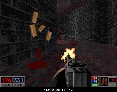

    I'm really disappointed with the quality of the youtube video. While the quality of the original wasn't great, it is noticeably better than the youtube version. The original resolution was at 640x480 (although natively the game ran at 320x240 in Dosbox). I've uploaded a screenshot from what the actual video looks like below:
    So... how can I make a video such that youtube won't diminish the quality? I've heard that at HD resolution youtube maintains the quality. By the youtube standard, I would then have to upscale the video to 1280x720, however that messes up the aspect ratio. Is it possible for me to upscale the video to this resolution, while adding black columns on the left and right to keep the aspect ratio of the actual video intact?
    I don't even know if this is how I can upload the video without losing quality. Whatever suggestions you have I'll be very grateful. I have the program avidemux.
    Thanks a lot, really hope you can help. Best.

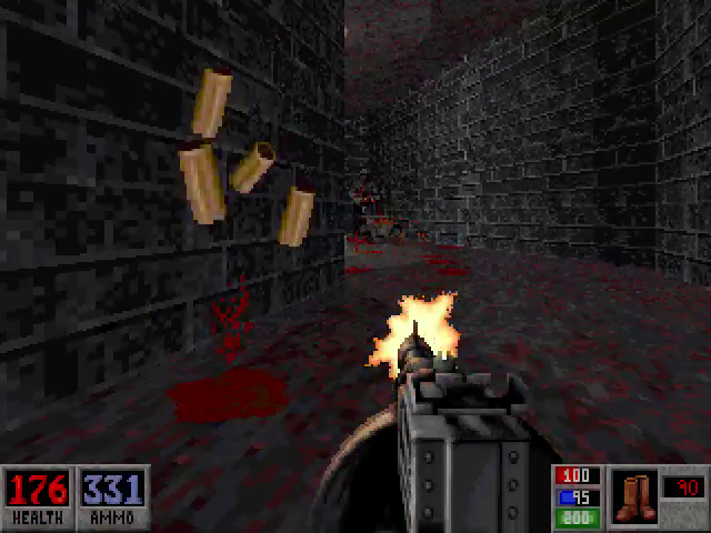

  2. Yes, upscale to 960x720 and add black borders to make 1280x720. I'd look at a better resizing filter. Point (aka Nearest Neighbor) is one of the poorest.
    nnedi3_rpow2+
    You'll to learn AviSynth for that though.

    Ummm...the example in post #5 is very pixelated. I thought the OP wanted to smooth the jaggies.

    I would like the best picture possible.
    If I could get it to look like post 5 that would be amazing.
    I don't think it's possible to get it looking that great however because the quality of the source video is nowhere near that.

  17. You may want to run AAA() before upscaling rather than after. If you prefer the pixelated look use PointResize() instead of Spline36Resize() and don't use AAA().
