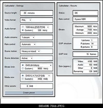

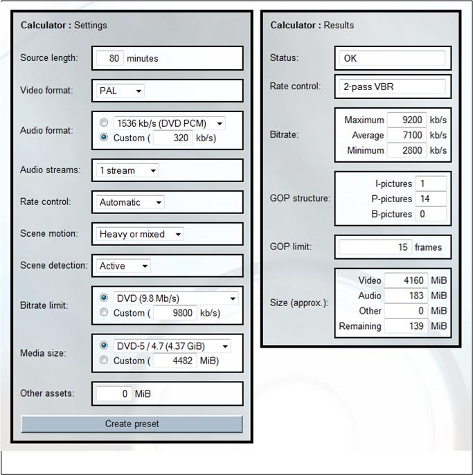

  3. this calculator: http://dvd-hq.info/bitrate_calculator.php would give you safe bitrate, around 7100kbps, so perhaps there is difference between them ... sorry about that, I thought that they are more reliable, .., as I said I start with 4.1 GB , having audio always about 256kbps, and using that 34400000/time_in_seconds and it always works, it is quick as well, btw you've been told to use 7100kbps

  4. That looks a lot easier to relate to Template ... I'll give it a go .... thanks for the perseverance,
  5. OK ... put the figures in the template ... setting audio for 320kb (AC3)
    It gave me the following:

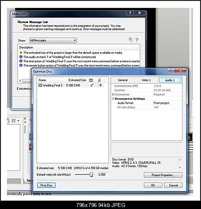

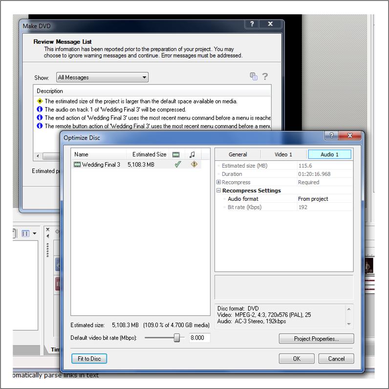

    Put those into Render template, and it gave me the Renders but when I load them into DVD Architect it still fails ...
    Reporting file is too big for disc .... yet file is only now 5.1Gb 109% of disc size.
    Do I just need to dial down bitrate even further ?

  6. Noticed one point .... Default video rate is set at 8 Mb (bottom of previous picture)
    On Calc program it had 'Bit rate limit default as 9.8
    It can be dropped to 8.0 .... but when I change it, only Maximum bitrate changes(drops to 7450) - so this may have no bearing ..
