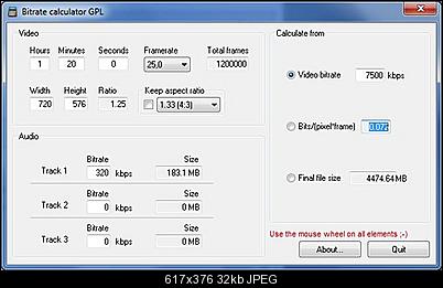

    I downloaded Bitrate Calc ... and have input numbers .. is this correct ?
    I don't see how this accounts for VBR ? or do I just set Bitrate filed to VBR max ? ... feel free to educate me

  6. Member DB83's Avatar
    Jul 2007
    224kb audio would be mp2. But 44khz is NOT dvd compliant. So maybe, just maybe, the program is telling you I must reencode the audio just for that reason since an avg 6,000 bit rate should be fine for 80 minutes
    The 9500 kbps is the dvd maximum but that will include PCM audio which itself gobbles up 1.536 kbps.
    Use the calculator and input numbers for greater accuracy.

    You just need the video bit rate in that box for the calculator. But it only accepts one figure so you enter the maximum. Try 8000 and below that.

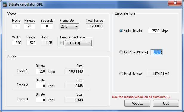

  25. Thanks for the numbers explanation ...
    I will try using BitRate Calculator going fwd ....
    If I use AC3 bit rate will be 320
    I have input run duration & frame size, so I then adjust video bit rate to get it to be less than 4.7GB ...
    So this '7500' videorate is what I would put in as the "Average" ...in my Render setting ...... that was the bit I didn't understand previously whether the number in this calculator gave me peak or average.

  27. on Render Template it gives me 3 fields to enter ...
    Maximum, Average and Aluminium
    on BitRate Calculator only gives one number 'video bit rate' .... so when I run Bitrate calculator the number for 'video rate ' .. 7,500 do I enter that in average field? and then enter something else in maximum & minimum ?
  28. Member DB83's Avatar
    Jul 2007
    Consider the bitrate for the calculator as the maximum. Then you know that your files should fit. But for a dvd, you should always allow enough the overhead (menu etc.)

  29. Previoulsy I had used :
    Max 8,500,000
    Avg 7,500,000
    Min 192,000
    If I use the settings you suggest
    Max 9,200,000
    Avg 7,500,000
    Min 5,500,00
    Won't that dramatically increase file size ? .......... raising minimum bitrate from 192Kb to 5.5 Mb
  30. the total size (volume) for your DVD sets average bitrate
    minimum and maximum bitrate do not influence your total at all,
    that example of yours above my post gets always the same size for DVD, both DVD's would have same total volume,
    as long as average bitrate is the same, so is the total volume of your DVD
    I forgot to answer your question, just to be sure, answer is no, not at all.
