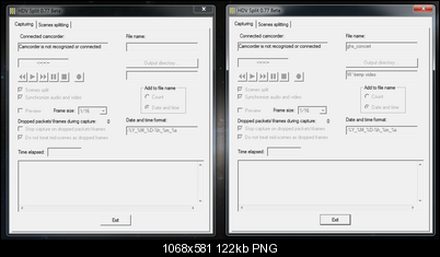

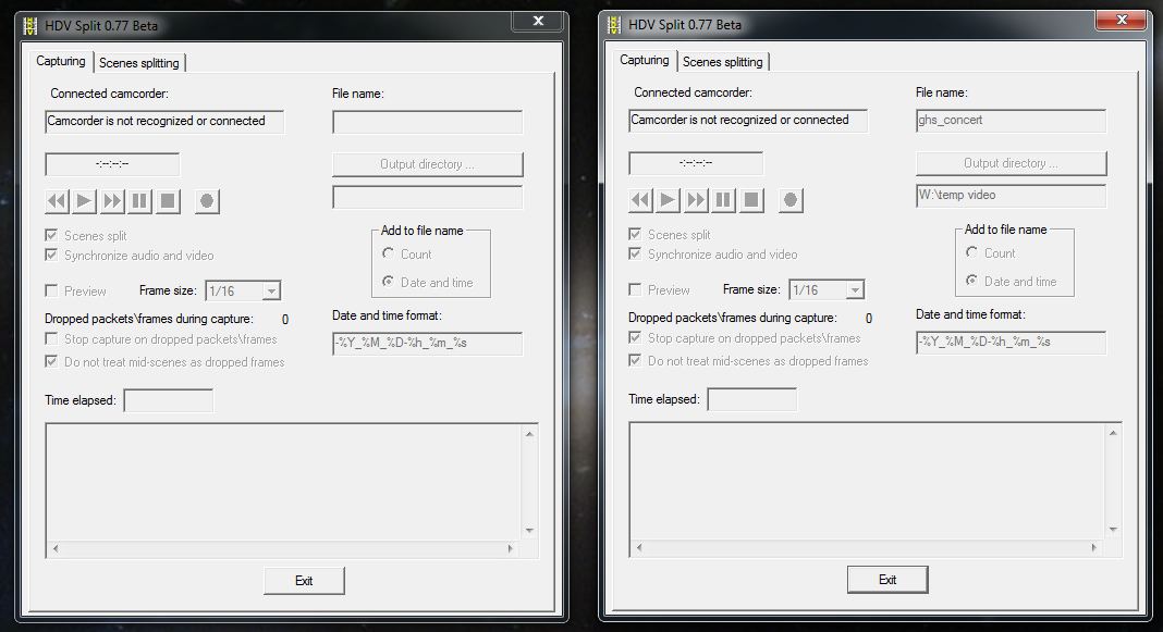

    you can have multiple copies of hdvsplit runnning at the same time. with 2 firewire cards it might work. saving to different hard drives might be required.
