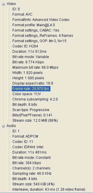

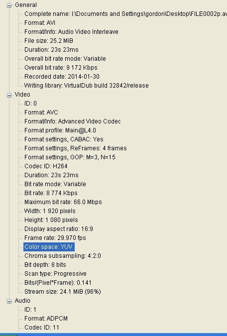

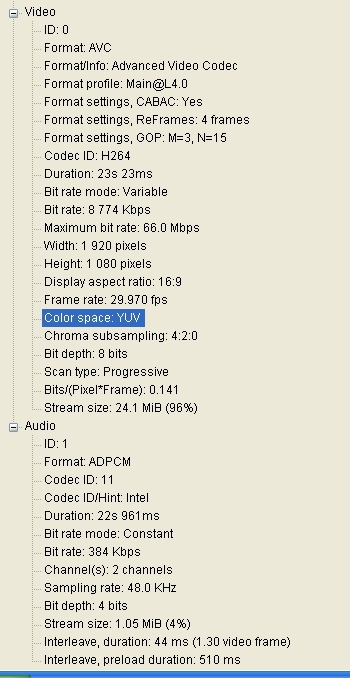

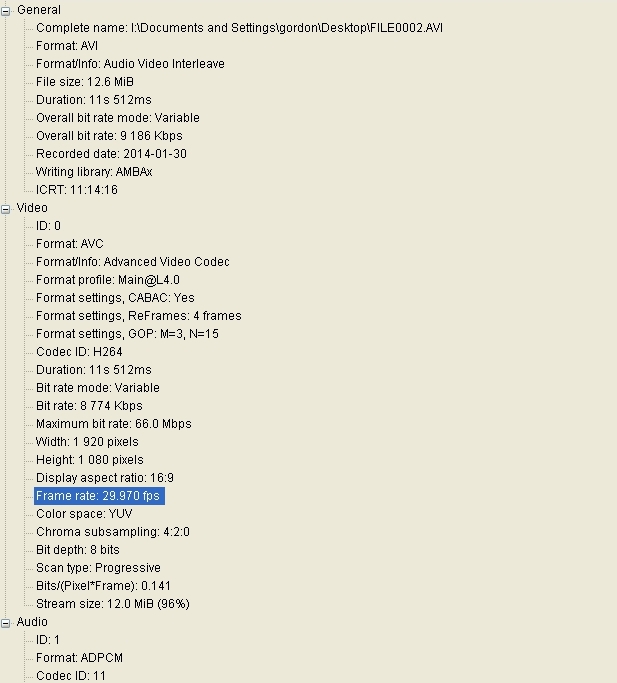

    Hi....I cannot get Isobuster to read the sd card. However,I am sending the info from mediainfo.......
    MedianA avi .jpg x2 relates to the original video clip. mediainB avi.jpg relates to the avi after processing in
    virtual dub. I have also sent the original avi fragment.
    The SD card is a standard Maxim Class c4 4GB memory card. Note,I also uploaded the G spot info.
    Thanks.

  4. Member Cornucopia's Avatar
    Do me a favor:
    As a test, download your "File0002.AVI" (don't use your original, use a copy that has been downloaded from this site's upload). Add it to a BLANK, REFORMATTED SD card (that has been formatted by the cam, not by a PC).
    Does it play? If NO, then either your export process is faulty or the cam doesn't like files added without some other kind of index/thumb/TOC info.
    If it DOES play, next download the file I am uploading. It is the exact same file as yours, except the "writing library" info ("AMBAx") has been zeroed out in a hex editor. IOW, no other info has changed and the file is EXACTLY the same size. Swap it with the original onto the same clean SD card.
    Does IT play? If no, and the other file played, you know for certain that the cam is checking the writing library to see if it is "one of it's own".
    If it DOES play, troubleshooting will be more complicated, because it means that other, possibly multiple factors are being checked.
    Of course, it could have something to do with how you JOINED the file in Vdub. I assume you used direct stream copy mode (for both V and A streams). Anything else would be more severely modifying the file.
    As stated before, a peak into the formatted file structure of the SD card might yield some clues also (hence the request for the ISOBuster screencap).

    This tells me at least 5 things:
    1. You don't seem to truly pay attention to what I've been trying to tell you.
    2. You have a bit to learn regarding troubleshooting, video formats & Virtualdub
    3. If you reformatted your SD card AND copied the uploaded-then-downloaded copy of your original file back onto the card, and it PLAYED OK, yet doing so with my copy DOESN'T PLAY, that means specifically only one thing: Your cam needs to see the "Writing Library" field = "AMBAx".
    This is a good thing because it could mean an easy fix. If you knew of a known good file (correct parameters, etc), all you would have to do is hexedit the writing lib to read what it needs. Would be even easier & safer if you had a RIFF container editor, unfortunately ABCavi (the best & most well-known AVI RIFF tag editor) doesn't support that field.
    4. While we still haven't gotten the full info from you, I can at least gather that your SD card's main media files are located in a DCIM (or DCM?) folder. Further structural info may give more clues, so could you give us that info?
    5. Anytime you process with Virtualdub, you are no longer doing just a direct stream copy, and if you didn't specify the codec particulars, THAT is why it is more MB (it chose "Uncompressed" or something). If one does no processing, AND makes sure to set the mode to DSC, your filesizes (for the same length) should be nearly IDENTICAL.
    Note: the "Writing Library" field exists in the JUNK chunk, and so the actual necessary formatting of the field is proprietary, and may require more than just those few characters to be changed.
