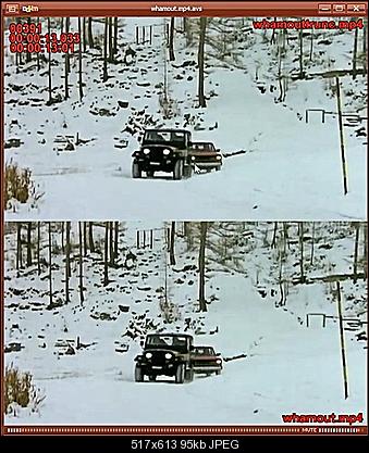

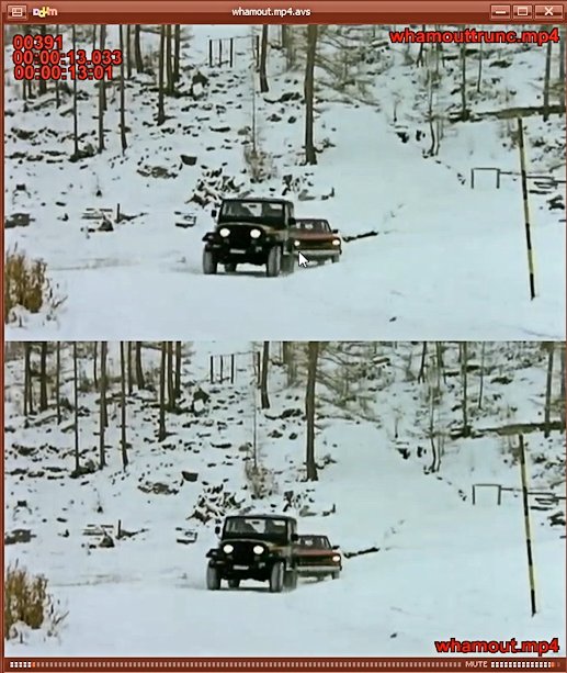

    Little late reply here but I use a player that accepts AVISynth and stack the 2 videos and then frame by frame advance to check PotPlayer works great but others also work). If you use something like:
    v1=DirectShowSource("C:\Users\Bud\Desktop\VHS2DVD\ whamout.mp4")
    v2=DirectShowSource("C:\Users\Bud\Desktop\VHS2DVD\ whamouttrunc.mp4")
    stackvertical(v2, v1)
    Subtitle("whamouttrunc.mp4", font="Arial", size=24, text_color=$ff0000, align=9)
    Subtitle("whamout.mp4", font="Arial", size=24, text_color=$ff0000, align=3)
    ShowFrameNumber(scroll=true, x=10, y=27, font="Arial", size=24, text_color=$ff0000)
    ShowTime(x=72, y=44, font="Arial", size=24, text_color=$ff0000)
    ShowSMPTE(fps=30, x=68, y=61, font="Arial", size=24, text_color=$ff0000)
    You will see as below. Notice the Arrow showing Video whamouttrunc.mp4 is .066ms ahead because it is 2 frames shorter (Hence the TRUNCated name. I cut 2 frames off.)
Name:	ScreenHunter_56 Feb. 04 10.29.jpg
