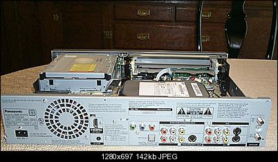

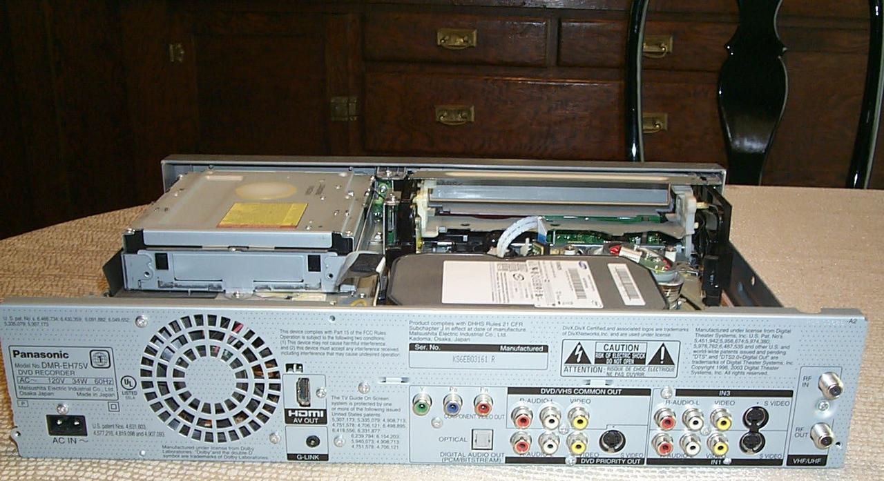

    Here's the back panel, via AVS Forum:
    I've never understood the wording "DVD Priority", but doesn't the "DVD/VHS Common Out" show that it will only do composite for VHS? I couldn't find a specific reference to VHS over HDMI in the manual.
  11. Originally Posted by vaporeon800 View Post
    Originally Posted by orsetto View Post
    I believe the EH75v is one of very few devices that can output VHS signals on those connections.
    [Attachment 23163 - Click to enlarge]
    It does allow VHS output from HDMI and component.
    Sent from my SCH-I535 using Tapatalk
  12. Originally Posted by vaporeon800 View Post
    As with most electronics companies, Panasonic's user manuals are 50% informative and 50% gibberish: inevitably any specific fine point of operation you want to know about is obfuscated, incorrectly described, or omitted altogether.
    The output jacks labeled "DVD Priority" are a perfect example of gibberish: the label only half-explains how those jacks work and doesn't give any context to how they compare to the other connections.
    The explanation is this: the better-grade Panasonic combo DVD/VHS recorders (including the EH-75v) have an unusual, almost unique ability to separate the line output signal of the built-in VCR from the line input of the built-in DVD (or HDD) recorder. Unfortunately the nomenclature is inscrutable so there is no way of knowing about this unless you use such a unit and stumble upon the added functionality. The output jacks labeled "DVD Only" do just that: they are dedicated to the DVD/HDD section of the EH-75v and the only signal they will play is from that section of the unit (if the VCR is engaged you get no signal or a black screen). The line outputs above these, that are labeled "DVD-VHS Common Out," have an undocumented dual function. In normal operation, they output whatever mode the EH-75v is switched to: DVD, VHS, or HDD.
    However, advanced users who discover the need for a "black box" (TBC, protection filter, proc amp) can insert this device between the built-in VCR output and built-in DVD/HDD input. You do this by switching the unit to VHS mode, connecting the "DVD-VHS Common Out" to the black box input, connecting the black box output to any of the EH75v line inputs, and connecting the "DVD Priority Out" to your TV. With this hookup, the VHS signals are re-routed from the internal connections thru your external devices and back into the DVD/HDD section of the unit. The "DVD Priority Out" connection lets you monitor the DVD/HDD activity as if the built-in VCR was external. This ability is very uncommon: the majority of DVD/VHS combo decks cannot operate their VHS and DVD sections as independent inputs/outputs, so if external hardware needs to be looped in you would require an additional external VCR to do it.
    Regarding VHS playback thru HDMI and component connection, this is another nifty Panasonic near-exclusive that is not terribly well documented. Most combo decks deactivate HDMI when VHS is selected: it must be played thru the standard analog connections. Many combo decks also deactivate component output when VHS is selected. AFAIK, only Panasonic offers playback of all internal sources (DVD, VHS, HDD) thru all available outputs. This simplifies connection to the TV, and allows flexibility with various capture devices (depending on the tape and encoder, you may see cleaner VHS thru HDMI or component than you would via composite or s-video). All things being relative, of course: the EH75v is a consumer-grade device, so one can't expect it to work miracles just because its low-end VCR can play VHS over HDMI. More demanding archivists, or those with huge collections, will probably prefer a separate VCR with additional signal processing features. Also, the majority of 2006-era EH75v recorders have blown their power modules by now: model scarcity + repair costs make the EH75v impractical second-hand. This discussion might be of academic interest to existing owners, but the EH75v hasn't been a viable option for anyone else since its discontinuation seven years ago.
