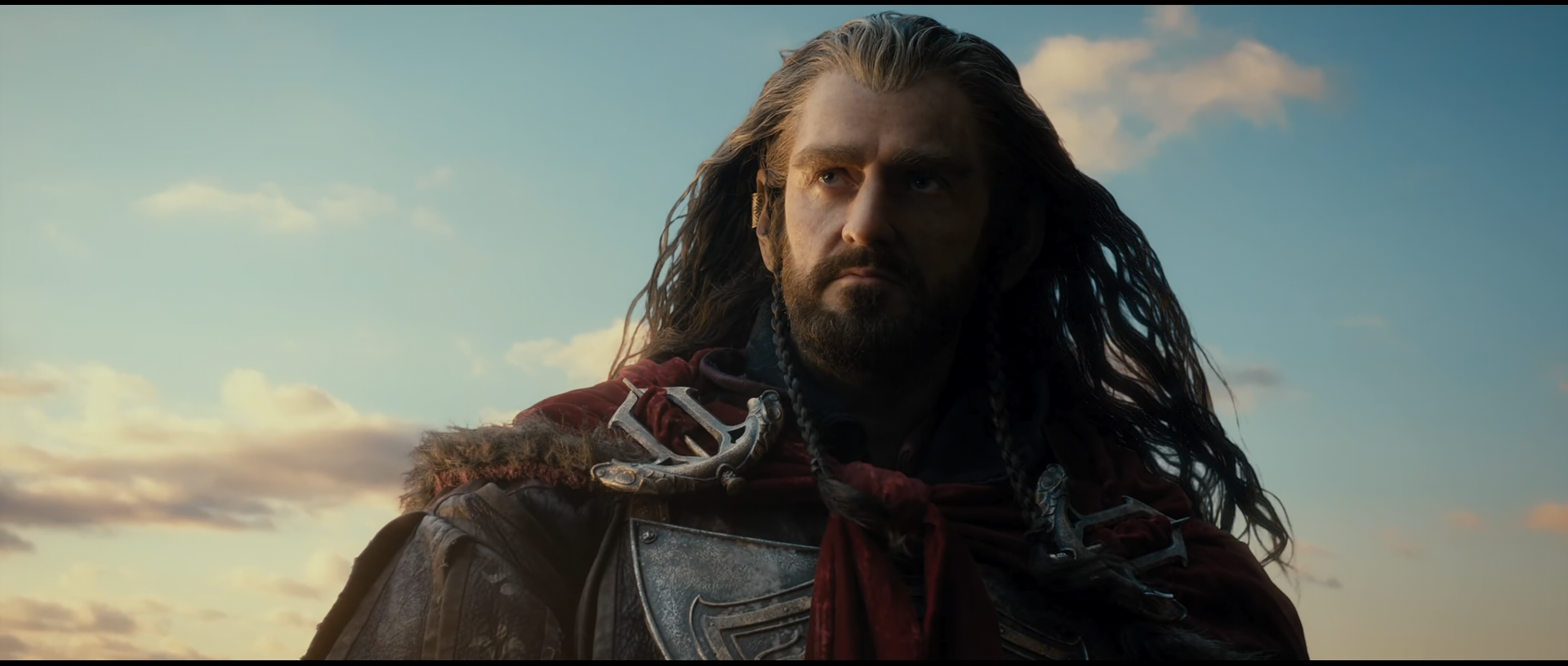

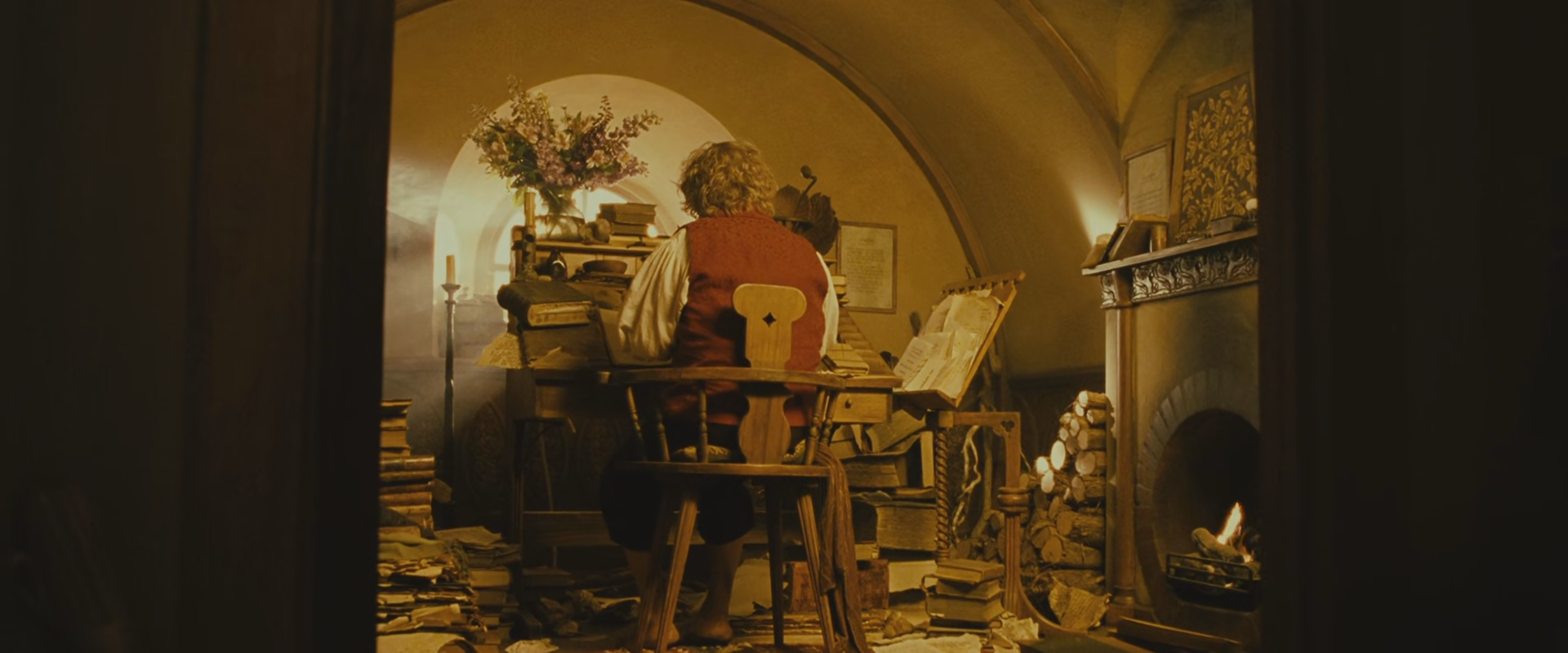

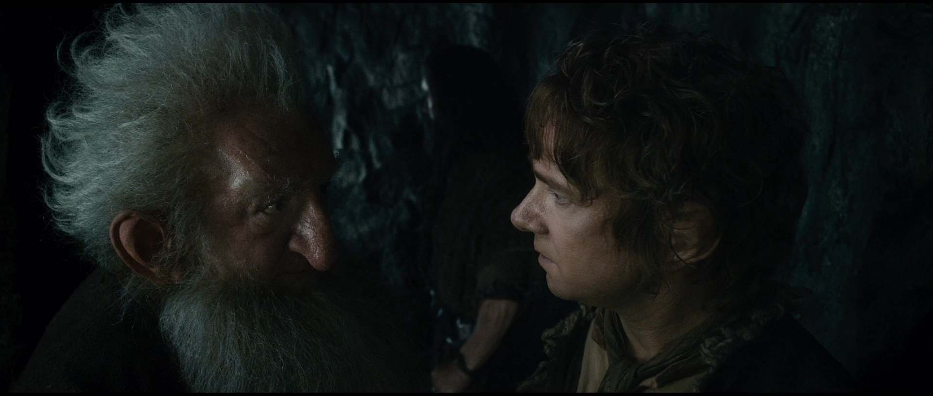

Hello people.
As it takes longer to encode, I still prefer to encode in Hevc/H265-10Bits through Hybrid as sample below. Video is perfect. This is just my simple opinion as an end user and could not help but opine about it .
Deadrats, Thanks for opening the discussion in the forum (vp9 vs x265 vs DivX265), which is very important at this time of adaptations and adjustments for all involved in these new codecs.
Link Sample Hevc/H265-10Bits:
or
